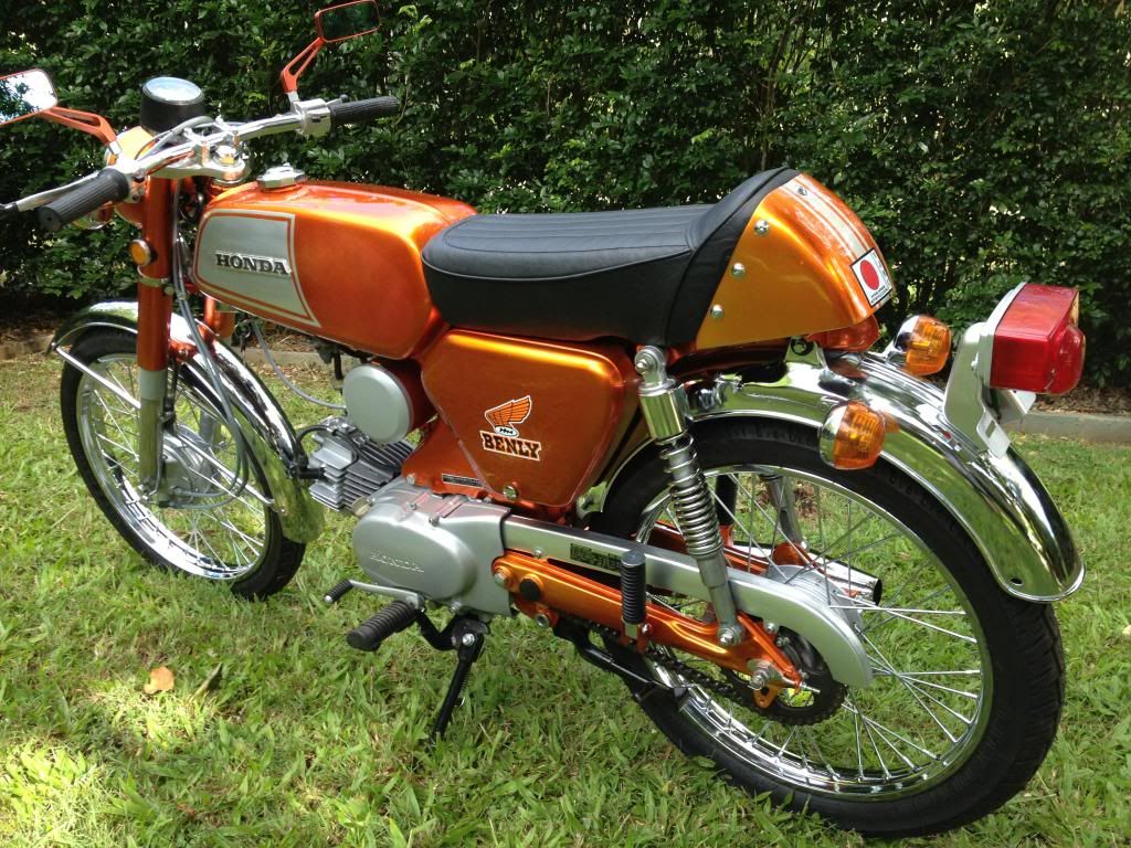

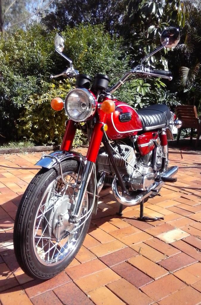

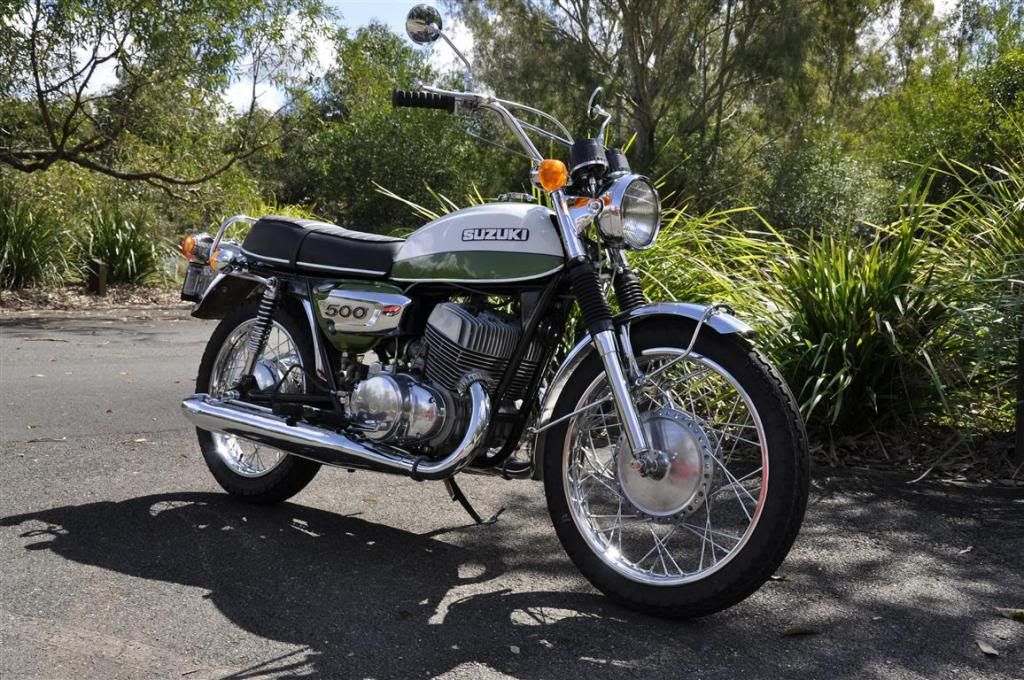

RE: My Z1 - Tezza_imp - 12-14-2014
Here are some of my other gems.
[url=http://s1200.photobucket.com/user/neilsot/media/_DSC0310Medium.jpg.html][Image: 41582f44050121bab80a3bc2c9b1f8c2.jpg]
[url=http://s1200.photobucket.com/user/neilsot/media/20140909_085642_zps1be7720c.jpg.html][Image: 18bcb057fab75fe2fc670c1da8cfe971.jpg]
[url=http://s1200.photobucket.com/user/neilsot/media/IMG_0118_zps4acd4a19.jpg.html][Image: cd56b474e00f0b210a87b046e6f8acfc.jpg]
