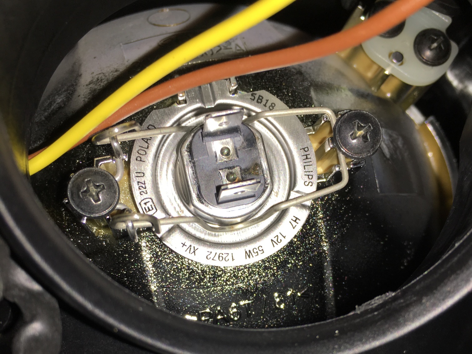

Here's a picture of the bail on one of the GT headlights. People who don't use a camera or mirror to inspect and who aren't alert to the chance for damage are breaking off the three little plastic tabs on the right side near the screw.

Stitchil,
So what is the proper way to get that off? Remove the screws?
RE: Headlight bulb - Stichill_imp - 06-27-2019
Popgun, you push down on the ends of the bail on the left and move them inboard. This frees them from the upside-down ā€œUā€ retainers. Then you pivot the bail outward and toward the right.
RE: Headlight bulb - Lord Popgun - 06-27-2019
Thanks Stichill!
I expanded the pic and can see now how it works.
RE: Headlight bulb - rboe - 07-01-2019
There is a knack to that darn bale. Some times I find it foolishly easy. Other times. Not so much. Curses.
