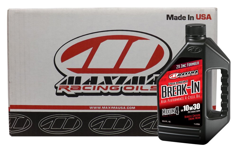

I just purchase this for the break in period.
http://ecx.images-amazon.com/images/I/61FHwoOGhmL._SL1500_.jpg
Seemed like a good way to go if you don't mind how much it costs... ouch.

some experts say that high amounts of Zinc dialkyldithiophosphates will destroy your catalytic converter.

Chemically speaking, they have a point. But that assumes that significant quantities of oil are getting past the rings and being burned. The CB1100 engine is pretty tight. I didn't notice any oil burn during the break-in period.
RE: Which oil at low miles - wayne van horn_imp - 04-13-2014
that oil is for high rpm racing engines, cb1100 is not that motorcycle.

It won't hurt anything, but that oil is designed for a "quick" break-in, that is, a couple of track sessions, rather than the methodical, even-handed method we've all used in carefully settling in the clearances on our beloved, classic, air-cooled babies.
Well, some of us.ROFL
Keep in mind one thing, too; the engines for which that break-in oil was formulated were not meant to last too long before tear-down. Excessive lubrication during break-in, for a road-going vehicle, is not necessarily a good thing. It could prevent parts from properly mating to one another.
I know that didn't sound right but there it is.Wink
