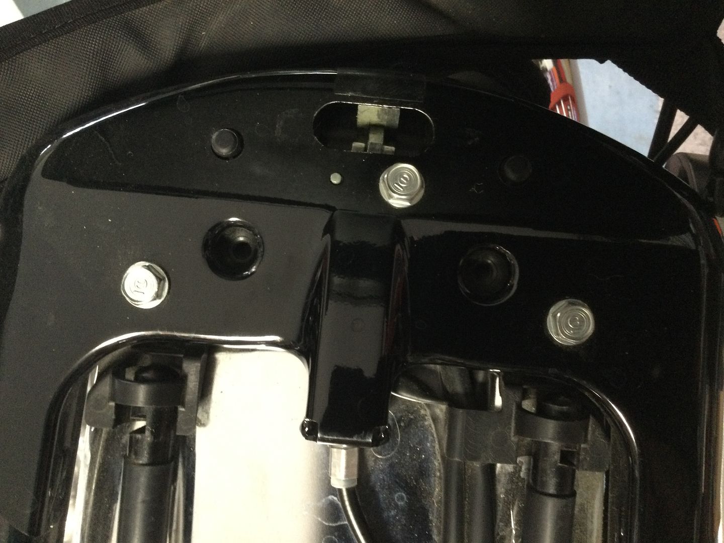

Here is what you are dealing with in case you need it:
[url=https://app.photobucket.com/u/everettmclendon/a/a8b5b03b-ad65-49a1-a3d0-f45df1fc2c20/p/9cde015f-8c53-44b3-9d1f-24d04eccf55a][Image: 28085dbcd1f6a36214a4f03debc56cfe.JPG]
Thats a seat bag strap right behind the frame. That why you don’t see the fender under it.

RE: Help! 2014 seat won’t pop off - max - 07-03-2021
Provided you have a "standard" low seat there is a possibility to perforate the seat at the back close to the seam with a 3mm flat screwdriver and manually move the latch in LPG's picture.
about half an inch in front of the bead puts you right on top of the metal loo held in by the latch but it should also work closer to the bead sown into the seat and look not so much out of place, if the hole is small and made with a needle like object it's shape may return almost unnoticeable and maybe need a bit of paint to hide it from view.
The metal loop in the seat, notice the open space in the top with the yellow foam showing;
place right above the latch;
Latch close up;
The bowden cable which may have slipped from it's position;
screwdriver inserted to move the latch back;
Hope this helps.

Max’s procedure will work, but I was hoping something could fished around the rear frame rail and push on the latch. Don’t know if that would work though. I’ll have to go push on it and see how hard it is to move.
Personally, before I poked holes in my seat I’d remove the security bolts from the latch actuator and do some pulling on the whole cable assembly.
