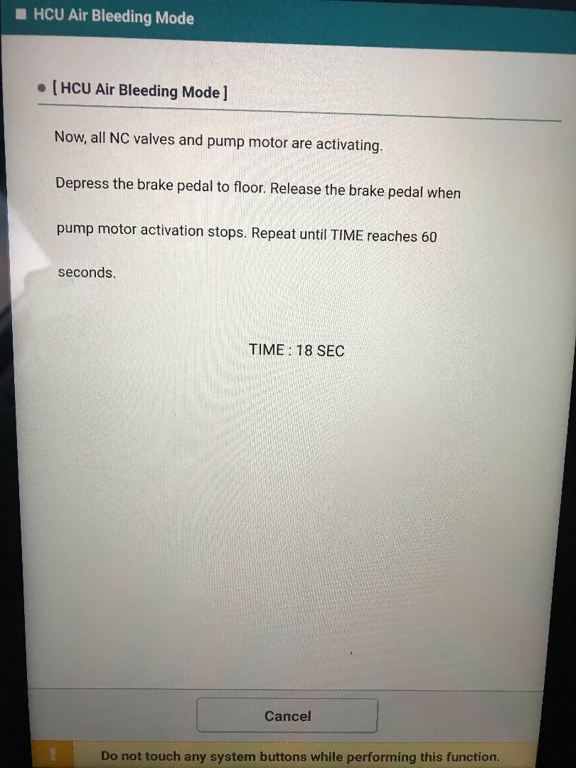

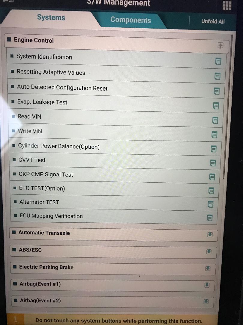

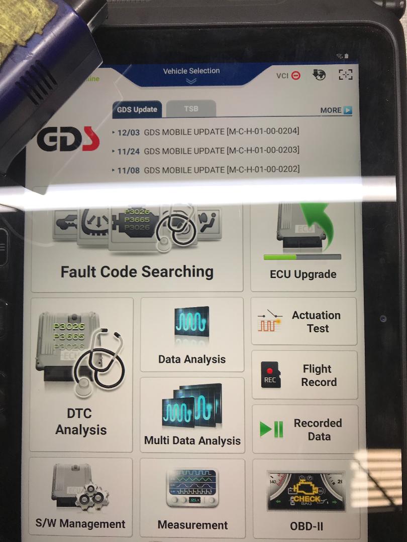

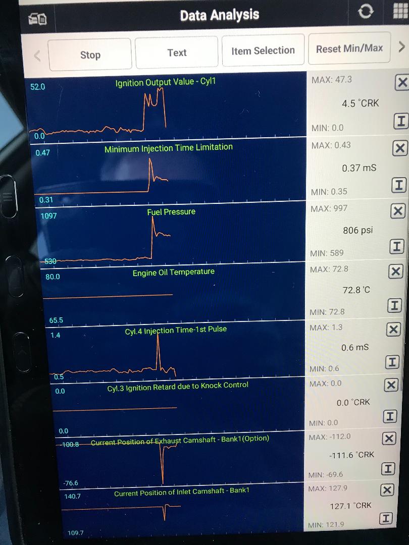

Sorry about this confusion, but as indicated by General info, it does not specifically concern a CB, however I hope to communicate with 2017 CB & up models/OBDII equipped.
I use a Samsung Galaxy tablet with a special automotive program called GDS /Global Diagnostic System that through a VCI wirelessly communicates with all onboards modules (ECU, TCU, PCM, MDPS, ABS/ESC, SRS, SJB, BCM, 4WD, BSD...), all supported service data reader/or its graphics, DTCs. Can perform an ECU update as well.
It also has many more functions like...multimeter, scope, camera, smart and chip key coding, VIN reading & writing, programs & neutralizes immobiliser, TPMS with special adapter, performs flight recording...and special tests ...++ for specific make(s)
It will read OBDII data to other makes as well.
It can activate/input: an ABS pump for bleeding purpose and its functionality, a lot of electrical circuit like lights, horns, cluster, electronic components or devices.
As Max mentioned, for our ABS and pump activation, there is no simple answer as to how to do it.
I think, one has to build a device to trick an ABS module into thinking that a wheel is traveling at a certain speed and then input a lock up signal to either one of the WSS...to activate an ABS pump and bleed brake system, or perhaps there is some other, more simple solution??
Hera are a few pics of the said GDS
![[Image: 23f8da8e1ceac3c94e7e46a613602570.jpg]](https://cb1100forum.net/forum/uploads/imp/202112/23f8da8e1ceac3c94e7e46a613602570.jpg)
![[Image: 6a89f5612c861c076612520f8f9157a0.jpg]](https://cb1100forum.net/forum/uploads/imp/202112/6a89f5612c861c076612520f8f9157a0.jpg)
![[Image: 2b6ff4af191909a47f3da8bee481bab0.jpg]](https://cb1100forum.net/forum/uploads/imp/202112/2b6ff4af191909a47f3da8bee481bab0.jpg)
![[Image: 2736d7ae85609ef46f3628a1141e7575.jpg]](https://cb1100forum.net/forum/uploads/imp/202112/2736d7ae85609ef46f3628a1141e7575.jpg)
![[Image: a801592b4b174b901efdd5d08cd91432.jpg]](https://cb1100forum.net/forum/uploads/imp/202112/a801592b4b174b901efdd5d08cd91432.jpg)
Edit: P.S. hope to guinea pig an AT and '17EX (both belong to friends )
