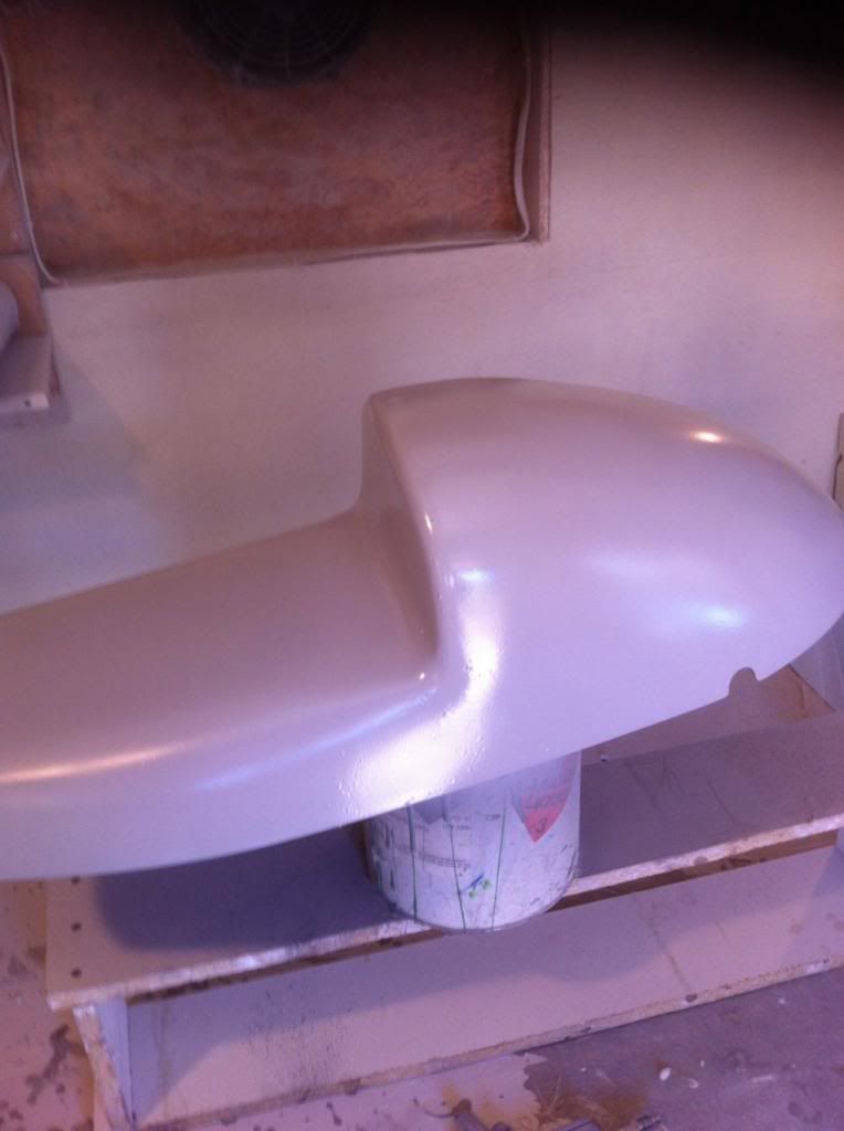

Seat is home made from fiberglass see below. Colour is something I concocted with the local auto paint shop, a very dark pearl blue with large blue metal flake.
Clubman bars are perfect for me as I much prefer the forward lean to bars over the standard upright seating position. Picture below showing diminsions. I would recommend a slightly wider bar to provide more room between brake banjo bolts and the instrument cluster. I have not changed the cables nor hydraulic lines as I was able to route them without any kinks however shorter front brake lines would be desireable. I have a set of braided front lines on order.
I am still experimenting with foot peg position however at this stage it feels OK. I tend to ride with the balls of my feet on the pegs so perhaps if the pegs were rearward by 75-100mm it would work also. I'll ride more miles before making any changes.

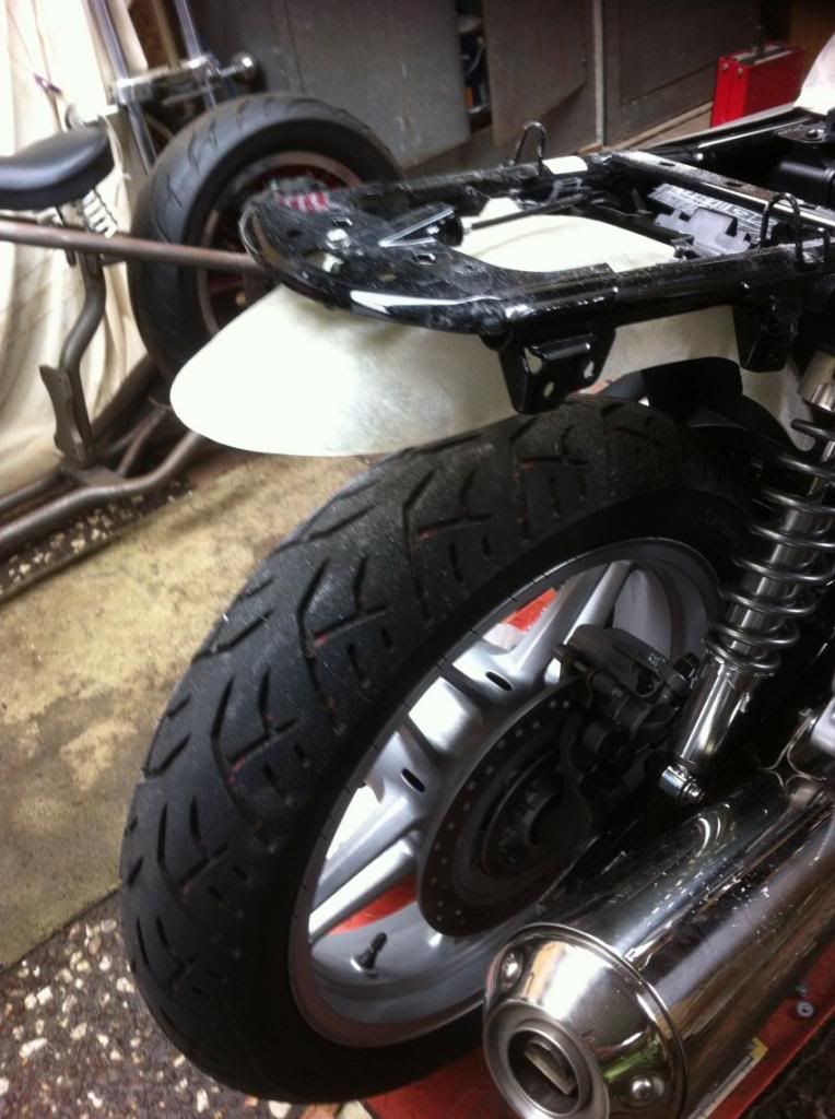

Seat construction:
My friend Mick making the base plate to fit frame tubes-
[url=http://s121.photobucket.com/user/aussieflyer1100/media/Motorcycles/CB1100%20Cafe%20Racer%20Build/01deck_base_frame_zps370b1fbe.jpg.html][Image: 4cc09478da347807cffdb784c555b878.jpg]
Fitting a ring around the base plate to give illusion of a flat frame for lower rear end-
[url=http://s121.photobucket.com/user/aussieflyer1100/media/Motorcycles/CB1100%20Cafe%20Racer%20Build/03deck_base_ring_2_zps6ba0148b.jpg.html][Image: d226c967a70bb61e649369f848d43246.jpg]

Spash guard moulded from original rear fender -
[url=http://s121.photobucket.com/user/aussieflyer1100/media/Motorcycles/CB1100%20Cafe%20Racer%20Build/05splash_guard_1_zps9bd95209.jpg.html][Image: 6e1172d56e028bbb2736449e1ead8ac1.jpg]

Ready for under coat -
[url=http://s121.photobucket.com/user/aussieflyer1100/media/Motorcycles/CB1100%20Cafe%20Racer%20Build/10undercoat_zpsb13295c1.jpg.html][Image: 7578613049d196ce14713429abf40a72.jpg]
