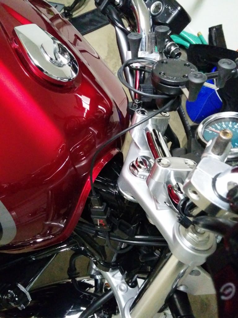

[url=http://s1375.photobucket.com/user/Kevin_Broce/media/IMG_20140523_205812_zps309aa50e.jpg.html][Image: d646e6d55372a516603ddd0f896c81e0.jpg]

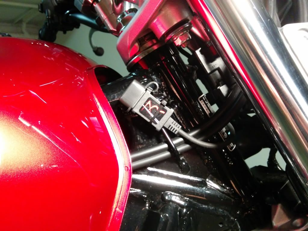

[url=http://s1375.photobucket.com/user/Kevin_Broce/media/IMG_20140523_221958_zps0cfc6293.jpg.html][Image: 0e791e71bec286862fdaba8a82830b15.jpg]
[url=http://s1375.photobucket.com/user/Kevin_Broce/media/IMG_20140523_205752_zpsc08cd697.jpg.html][Image: 17e214116652cf9429d5c772cae05416.jpg]
Can't take a photo of my phone mounted in the Ram Mount since I use my phone to take photos... But it works great. Ram mount has a ton of mounting options, I just went with the basic handle bar mount since it puts the phone right where I want it, but there are plenty of slicker options. I wired the USB charger into the heated grip plug since that power connections switched with the ignition. I didn't like the idea of wiring straight to the battery since there will always be a slight drain power drain.
