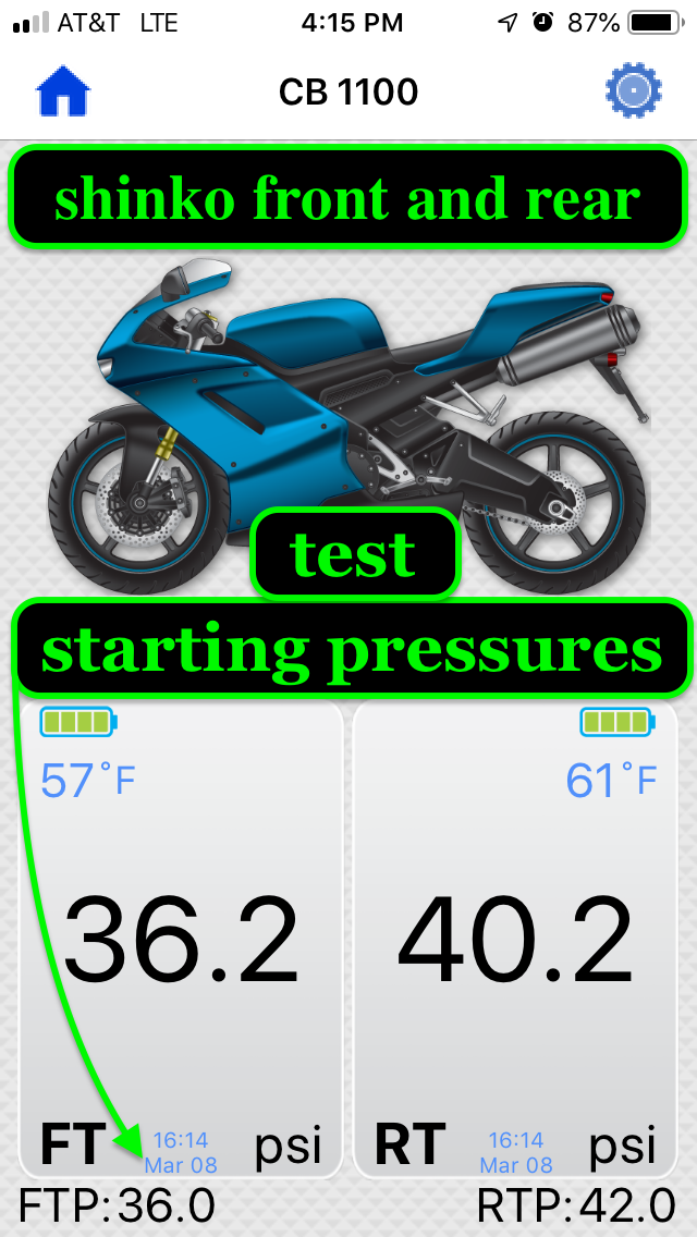

(03-19-2019, 10:40 AM)peterbaron_imp Wrote: PICS EDITION FOR CHUCKK::
[Image: 7842d9a5a82a3b5a0082f56680eb6124.png]
[Image: 9fc31a22283359cd84ec30382b8c6a10.png]
[Image: a06ca5b2ad0ddce3db874b78d0d84491.jpg]
Smile
hopefully, the tee valves won't cause the tires to be out of balance too much.. would this cause a wear problem? .. I don't know what exactly to expect.. ideally, I should take them in and get them re-balanced..

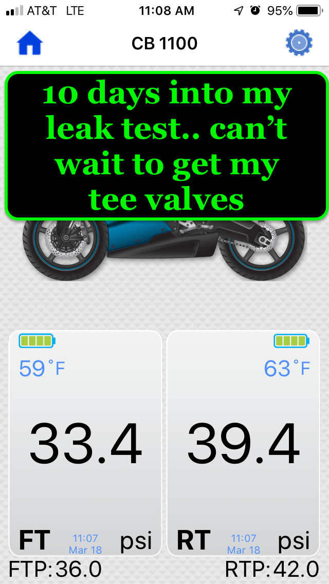

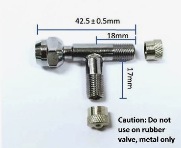

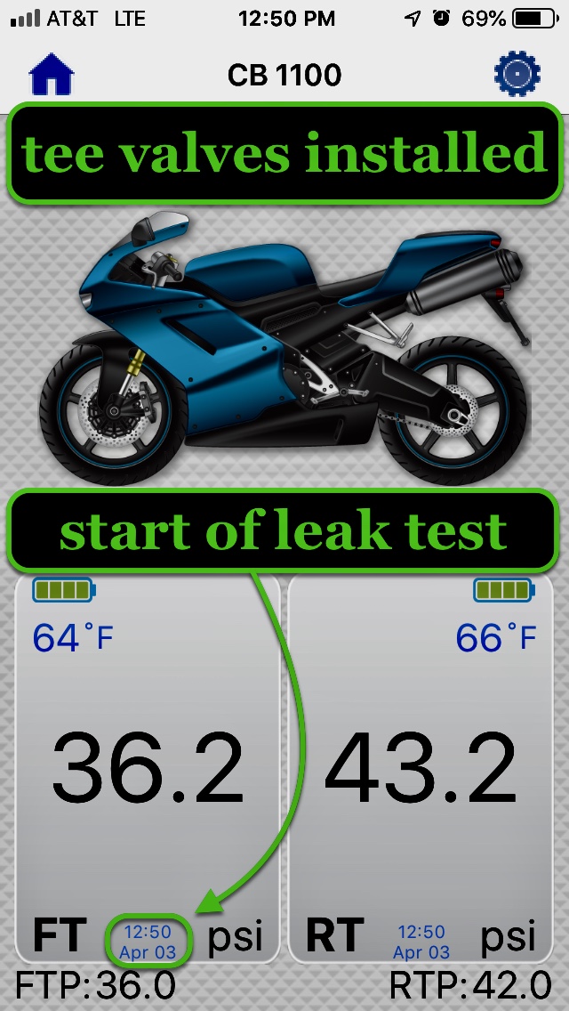

RE: Shinko 777 tires for my 2017 CB1100ex - Chuckk_imp - 04-03-2019
the tee valves have come in.. I have installed them and have had my wheels balanced once more.. the valves are setting pretty tall on the rims now, but are quite solidly mounted.. centrifugal forces shouldn't be a problem in the way I have mounted them.. I have taken pics and perhaps Peter would be kind enough to post them for me.. I have also captured photos of my FOBO, detailing pressures, starting dates of batteries, and leak tests.. the modifications I have done to the front fender to allow for that larger Shinko 777 120/90/18 posed no problems when pulling the front wheel to re-balance.. chuckk j.
