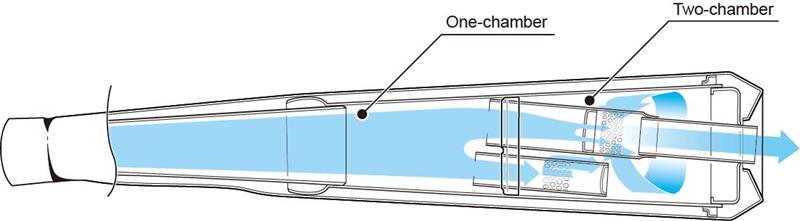

Take a look at the new muffler-
[Image: 099a405394f20354e4d441785bac9138.jpg]
Instead of a typical straight through perforated tube- they are creating their own pulses within the muffler to enhance the sound.

I've been wondering whether the slip on may have more to do w/ nuances than just for looks.
This back piece on the '14 dlx & ex being right at the biginning of the slip on...
[Image: aa67ac35ad3575fb705ecb1a2cc825cc.jpg]
...is this conical piece w/ a back plate doing the work to stop exhaust pulses?
b/c on the '17, it's not there...
[Image: ed6dc4d718d814145d5b8f8c4f00aeba.jpg]
