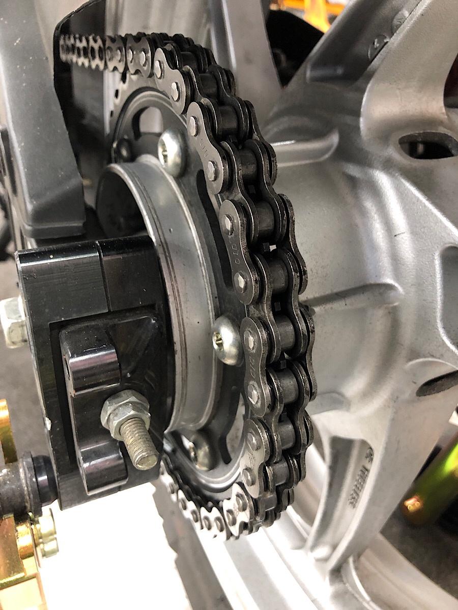

Went out on my lunch hour for a 45-minute ride. Outside temperature 72° F / 22° C.
Started at 1/2 turn as recommended in the workshop manual. Chain looks fairly wetted. I'm thinking if I rode longer it might become over-oiled. I cut it back to 3/8 turn and will do some more testing.
[Image: 43fe659a8b6558e6b23db3408ca506d4.jpg]
I can see that the oil has started to have the cleaning effect. Dirt is beginning to emerge from the crevices.
[Image: 15f76fcdbe0f454e104ca2578f5b1a5f.jpg]
[Image: 3ee7b1cfa0dfccdd5d2bb979381320dc.jpg]
One thing I'm not super keen on is the way dirt on the sprocket can get pushed into the nozzle when reversing. I always push my bike backwards into the garage. I suppose I need to just give the sprocket a wipe-down once in a while (no hardship with my new [url=http://cb1100forum.com/forum/showthread.php?tid=16815]Pit Bull rear stand!)
[Image: 00983f127ed9d9fbe47e460c18e96a96.jpg]
I'm curious how much the oil depletes on a typical ride.
[Image: 751e9fa417d954c4d9cfa8480435ef30.jpg]

This is the Tutoro oil I reckon? I find it flows easily and does clean as your pictures portray.
Ultimately I settled on synthetic engine oil (5W40). It is strongly suggested to not use conventional engine oil in the Tutoro reservoir.
Yes, that seems to be a strong draw down for a 45 minute ride. Local roads are very bumpy?
I typically get 1500 to 2000 kms from a full fill.

I thought it had used a lot, then I realized my earlier photo was on the side stand and the photo today was on the rear stand, so kind of hard to tell. I probably need to stick a piece of painter's tape on there just to see how far it drops in a typical ride.
Thanks for the 5W40 synthetic tip. That's a good recommendation coming from you as an experienced user of these systems. I was a little worried about the cost of always having to import their special sauce from England (although I'm not opposed to supporting Tutoro, just not DHL as well). I just noticed it is sold out on their website. Undecided
One thing that's a little odd is that the temperature range for the original oil tops out at what I would consider right in the middle of normal riding temperature range: 25°C / 77° F. It would be very common for me to leave home in the morning with temperatures around 18° C / 65° F and by afternoon it would be 32° C / 89° F. They mentioned that some riders make a 50/50 blend of both oil grades ("Original" and "Plus 25") to address this issue, making me wonder why they don't just offer the blend as the all-rounder oil.
