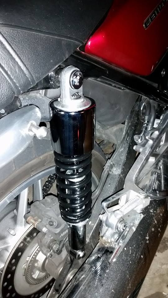

Had them sitting in the garage for a couple of months. The 7610's with the black springs and the long chrome shrouds to enhance the vintage look.
Took about 10 minutes to do, including the time to rounds up the tools
I didn't really have any issues with the stock pieces. They seemed to do their job fine. How much better could it be? I was quite surprised then, on the test ride to experience a more stable feel, less choppiness, with the rear tire sticking almost glue-like to the rough, undulating brick surface of my neighborhood streets. Hmmmm, there is something to this suspension upgrade after all.... Thanks to this forum
With the fork stiffened up, the adjusters turned in so that the top ring is flush with the top of the triple clamp, this little baby is quite the handler. Composed, solid, confidence inspiring. A great bike, made even better.

As they say, "Pictures or it didn't happen."
See it at CB1100DLX Face Book Group
[url=https://www.facebook.com/photo.php?fbid=912041818826551&set=a.455479797816091.105114.100000622234276&type=1&theater]https://www.facebook.com/photo.php?fbid=...=1&theater

Here's the pic from the FB Page
[url=http://s1318.photobucket.com/user/emptysea43/media/CB1100%20Miscellaneous/cb1100Ikon_zpsbe00a9b9.jpg.html]
![[Image: f3d08318f568eab47c55ab312bd173db.jpg]](https://cb1100forum.net/forum/uploads/imp/201412/f3d08318f568eab47c55ab312bd173db.jpg)
Good stuff! They are a quality unit.
I thought the stockers on my Bonneville were OK until I installed a set of Ikons. They made a substantial difference in ride on rough pavement and in handling - combined with a set of progressive fork springs.
I haven't ridden the CB enough to make that judgement yet, but I can maybe see a set down the road.
I bought the CB last April, but due to obligations and a domestic situation (add in all the other bikes too) I only rode the CB 2000 km's this year. On 31 October I parked it for the winter, but next summer it will see much more service.
