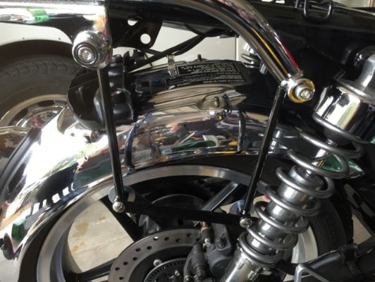

I have begun modifying my 2013 CB. I removed the right rear bar and loosened the fender in anticipation of relocating the signal lights. I have a universal saddlebag guard and a Honda luggage rack . It appears that the rear bar must be removed which means the rear signal lights must go. The view is from the top and from the front. The left rear fender area is intact, the right has been replaced with the bag guard. My first photo attempt. On the left side of the photo, the right side of the bike you can see the black spacers in between the rack and the bike.
[url=http://s1205.photobucket.com/user/geosar69/media/CB1100/IMG_0515.jpg.html][Image: a1b25dc7e480d8fe9f4512786ae9c979.jpg]
I need to figure out how to make the photos smaller. Here is the saddlebag guard and the Luggage rack loosely attached. The is the right rear side. As you can see, there is no obvious location for the rear signal light as the luggage rack and saddle bag frame take up the space.
[url=http://s1205.photobucket.com/user/geosar69/media/CB1100/IMG_0513_2.jpg.html][Image: b01306056720f91c9dc0e9a936ae8f6e.jpg]

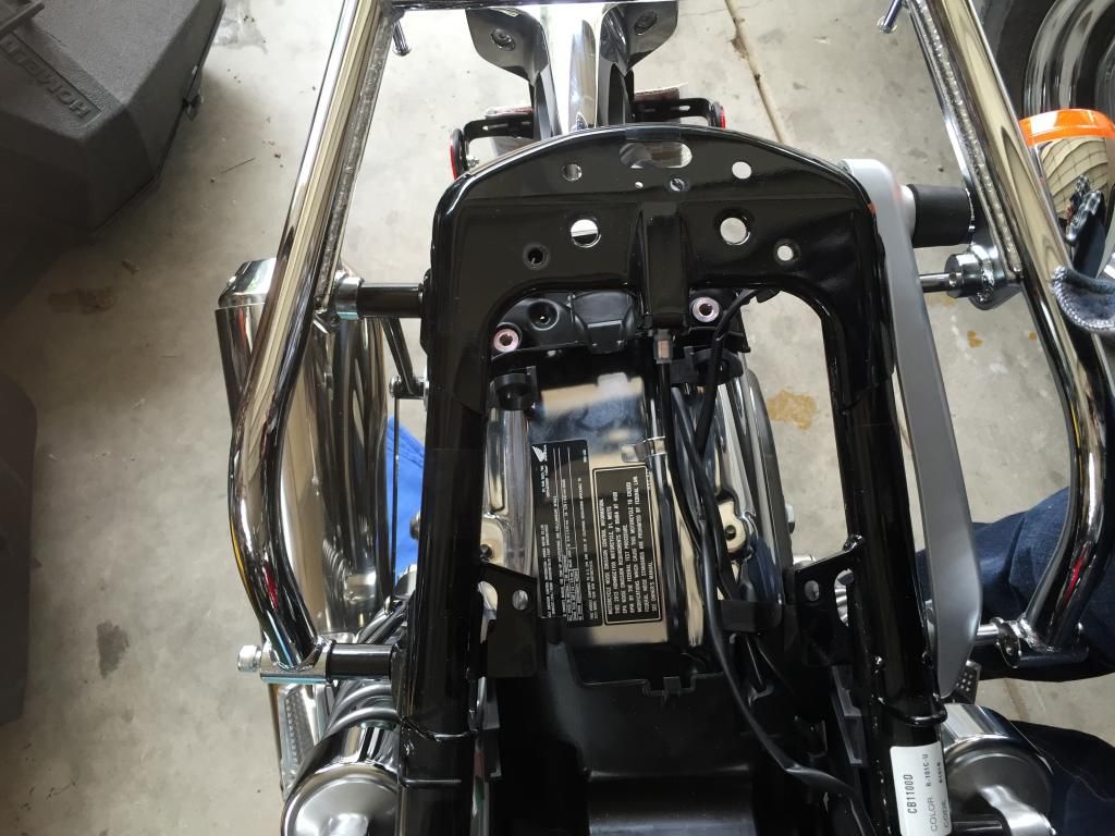

Here is a top view of both the Willie and Max universal saddlebag guard and the Honda brand luggage rack. There is no room for the rear rails or blinkers.
A rear view
The new wires are threaded through the existing tail light channel in anticipation of new blinker lights
