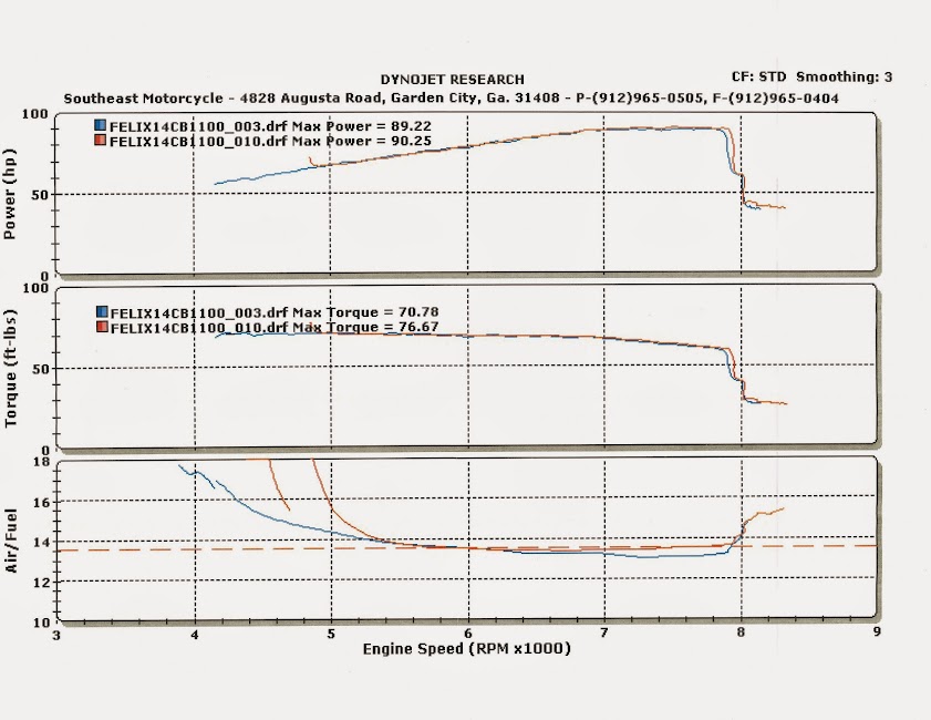

Note that Arrow has posted a dyno chart for the CB1100 stock, with slip-on and with baffle removed. With the baffle in, horsepower is very close to stock. With baffle removed, you get a small gain right at the top.

Those torque numbers are very good! your tuner did a good job maximizing low end and midrange on the power band.

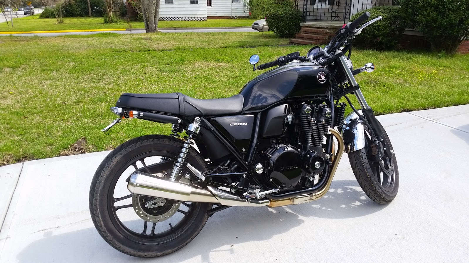

Anyways.... I'm loving the new setup. All of this conversation is over my head, bike is performing great even if the mod was necessary or not. Here's a new photo. If anyone is interested in seeing.. I also, just got done installing the fender eliminator kit and some new rear turn signals.
[Image: c773d330eb80a2233e7f3a39b1333815.jpg]
Lookin sharp!
agreed ! very simple and clean !
What about video, you can't hear pictures!
Thanks guys !! Yup, I like clean simple lines. Hikertoo, i'll get some video for you. Just give me a lil time.
