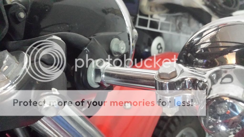

You will also need to find stems for the signals. My 78 XL175 uses the same signals, albeit 6 volt bulbs, and this is the type of stem it uses. The signal brackets are threaded and you secure the stem with a lock nut as seen here. On the CB, you'd need to have access to put a nut on the back side of where the stem goes.
These are shorter stems I bought off ebay to work with the splines in the signal housing. They are Bikemaster brand repops.
