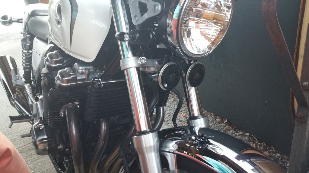

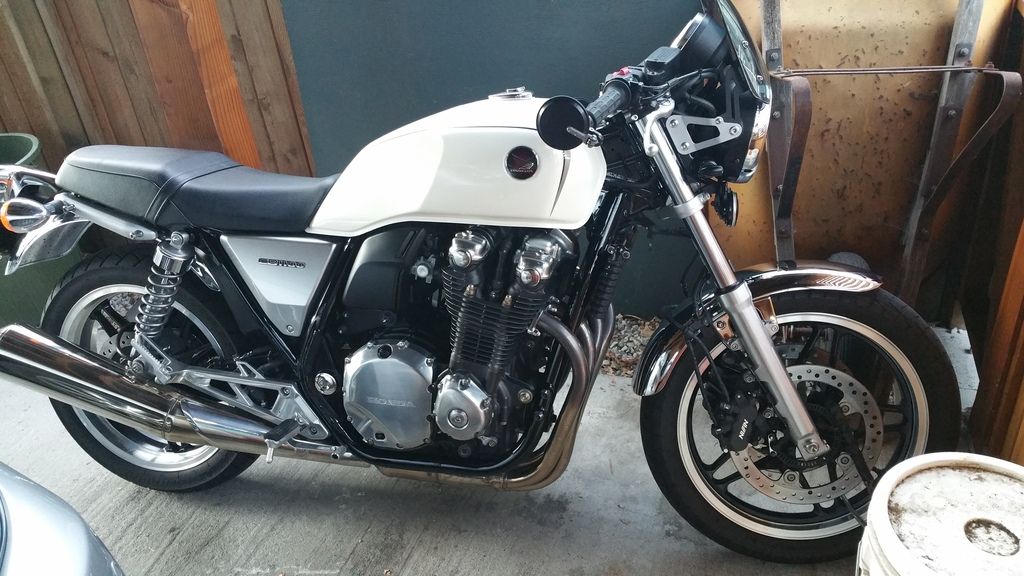

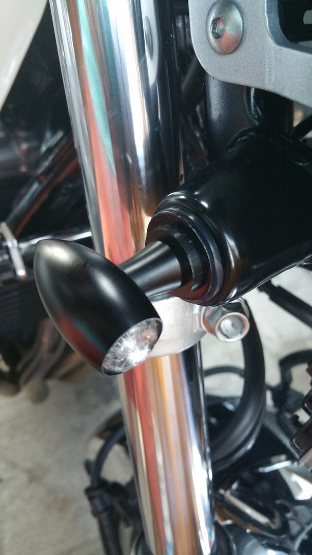

Put some rizoma Clubs on the front today (waiting on some Club S's for the rear, but backordered). I didn't realize how small they were in real life, but they really clean up the front end.

How visible are these to drivers?
They're tiny, but the light output from the LEDs is much more piercing and intense than the stock bulbs. They are actually EU homologated, so they put at least some effort into designing their lighting functionality. I definetely though of saftey and visibility before buying these and I think they are at least good enough. They make extension posts that move them our from centre,I may set some of those up.
Lighting tech has definitely come a long way. Safety is always my concern as drivers have a hard enough time noticing us-glad to hear these are effective. They sure do look cool! Smile

Here's the cool part!! Go to the Rizoma USA site. The "club" L signals and "club" S signals are set up to give you conspicuity lighting in front, and additional brake lighting in back. For only $10 more. In either black OR chrome.
Man, those are TINY.
Wow that really does clean her up. The turn stock signals have never bothered me, but this post has got me thinking...!

Looks great!
Yeah, I'm going to put the "S"s on the back to give extra brake and running lights (and possibly to sub as main tail lights if I do a fender eliminator). I'll post some better pics when they go on.
As a side note. The Club Ls discussed above are somewhat hard to wire, as our front turn signals double as running lights. The white running light wires can easily be wired into the red accessory plug in the headlight bucket and be switched by the ignition, but the amber bulbs will constantly be overriding them. It would need a different relay from a bike that doesn't use turn signals as running lights to work. I'm sure this is out there, but I didn't bother to look.
Running four of these signals also requires a solid-state flasher assembly that Rizoma sell for $40 cad. The ballast resistors these come with as an alternative get HOT.
