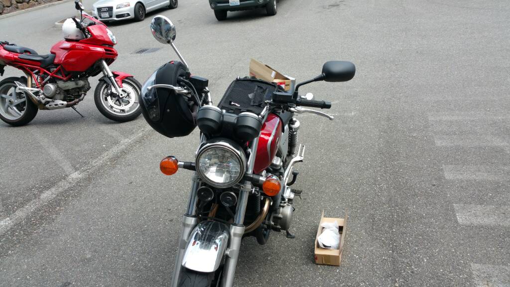

Just wanted to post a couple pics incase it helps anyone researching mirror options. I found these mirrors work far better than the originals on the freeway for seeing what is around me. You only need to replace the mirrors themselves, your original hardware is identical in size and the plastic boot covers the chrome hardware so the finished look is black.
First pic shows the two mirror styles. Stock chrome CB1100 on the left and stock black CB500F on the right. You can see the difference in height and width.

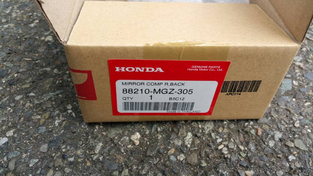

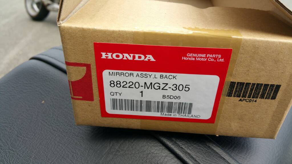

Part numbers for the mirrors:
88210-MGZ-305 Right hand
88220-MGZ-305 Left hand
[Image: f20ebe5fac19e9be7641960418a35365.jpg]

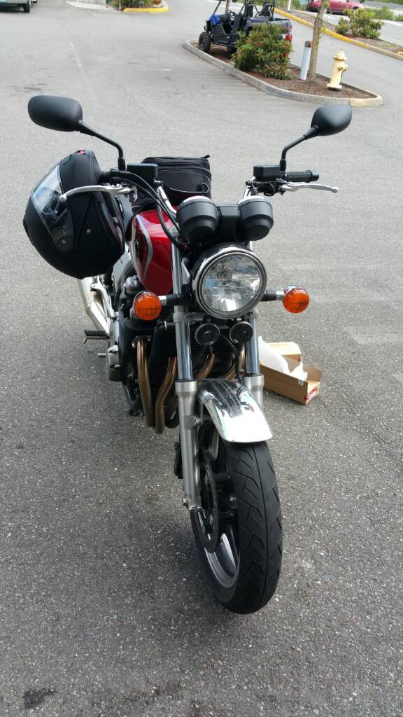

And last is the finished result.
[Image: 164ed22ef7b2356a6e2c3d7ac241bb7f.jpg]
