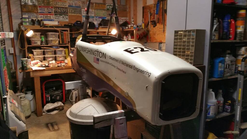

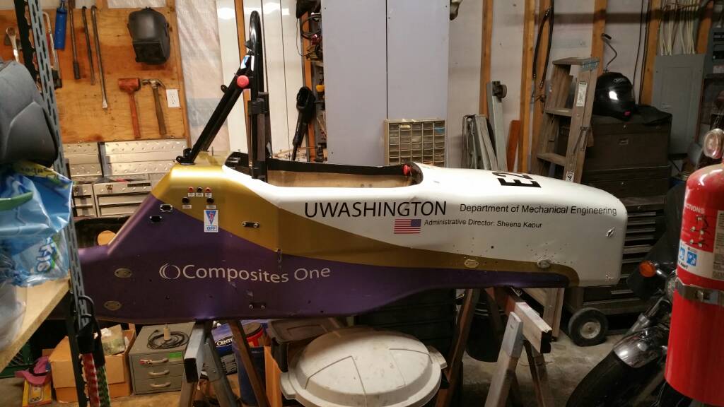

This is a vinyl wrapped carbon fiber chassis. High quality wrap, but horrible durability. The worst damage was done from poor handling after it was disassembled but it was damaged many times with meticulous care before that.
[Image: b466886cc9348cfcdf75e647bae7248f.jpg]
[Image: d4a6cc4f698447121154a9e41418b070.jpg]

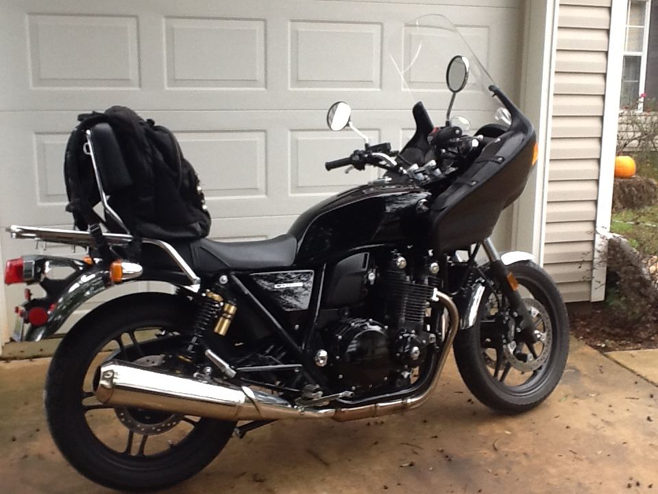

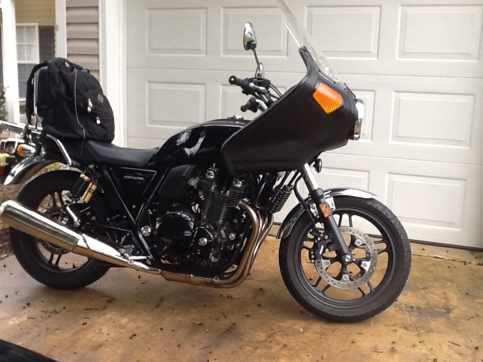

I found a close match Vetter bracket for the CB1100: 1980 Suzuki GS1000 but it will need skillful cutting and custom bracing and welding to fit around the CB1100 oil cooler. Its on my 2013 w/ a Vesco fairing which uses Vetter brackets. It doesnt photograph w/ the fairing on so I don't have pics to show the bracket.
Looks great. Fortunately I have a welder as well as all the tools I should need to complete the job, I think I am going to paint the fairing. I need to paint the factory wing on my wife's car any way and it is black as well. Thanks for the info.
