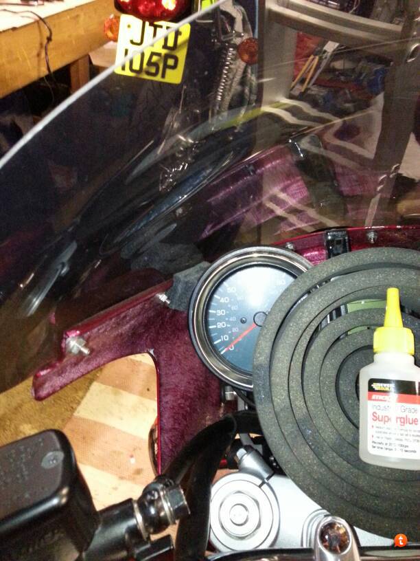

I did see that Dengie Boy added these additional support brackets
[Image: eb52d32048c2b0e9b02cb241dda9a710.jpg]
But thats was because the screen bounced around at anything over 60mph...
But I think this would fix my noise issue as well since the noise went away when I pushed the screen a bit forward.
