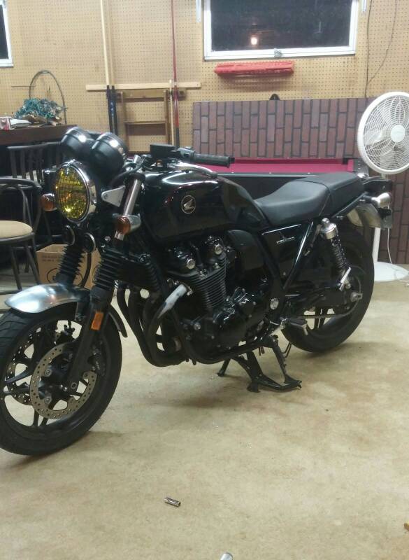

Just installed the Triumph gaiters and clamps on my "13. Someone else here made the recommendation.
I bet they last as long as the bike. Very well made. And i like the black clamps. Much better than stainless steel.
Fork gaiters: Triumph part #T2040349 (edited to correct part number. This one is right!)
Clamps: Triumph part #T2045157
You'll also need two screws( one per) for the clamps. The clamps aren't sold with them. I bought them from Triumph, but I can't find the package with the part #.
I think they cost me about $75
A picture would just show some black rubber thingies on my forks. I'm sure you know what they look like!Beer

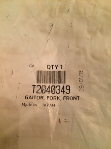

Are you sure about that part number? It comes up as a switch assembly.
[url=https://www.google.com/search?q=T2040309&oq=T2040309&aqs=chrome..69i57&sourceid=chrome&ie=UTF-8]https://www.google.com/search?q=T2040309...e&ie=UTF-8
I think he means T2040349
(03-14-2016, 08:31 AM)Lord Popgun_imp Wrote: [ -> ]I think he means T2040349
I do, Popgun. Thanks And thanks, Randy B.! And to think I stared at that number for five minutes before hitting send. Worship
[Image: e6fa0335245e18db8522fd2a9d0b2a81.jpg]
I'm going to edit my first post to show the correct number.
Sorry, guys!!

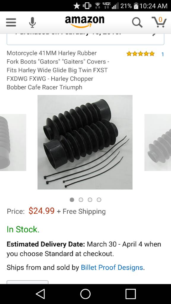

Word to the wise, spend the money on a good set of Triumph or kawasaki gaitors. I bought these, and although they work after notching out the lower bell on the backside, it was a pain to get them tight. Harleys must have a much larger lower fork. [Image: 7e91c7ef8f5a6e023f10f1e36db468b4.jpg]

I got the same ones, bottoms too big. I was going to return them but haven't yet. Did you notch them and make them fit good on the bottom? I had considered doing that....
Sent from me......
Yep, just cut a /\ out of the bottom with the point touching the lover bellows. It takes some time but it looks good once it's tight
