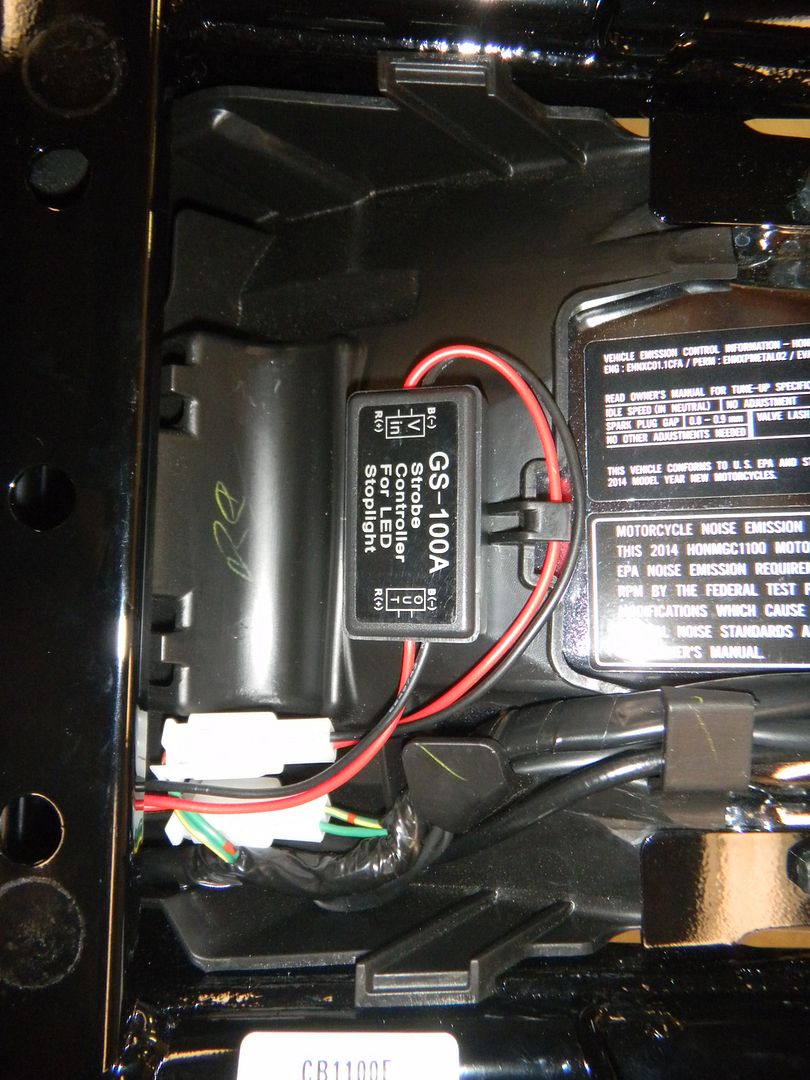

I'm cheap, so went with a $2 relay (eBay). Has worked well.
Wired it under the seat with opposing connectors. This way I can replace or remove the relay to go back to stock by plugging the connectors together.
