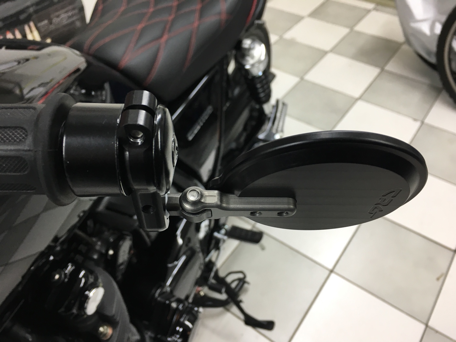

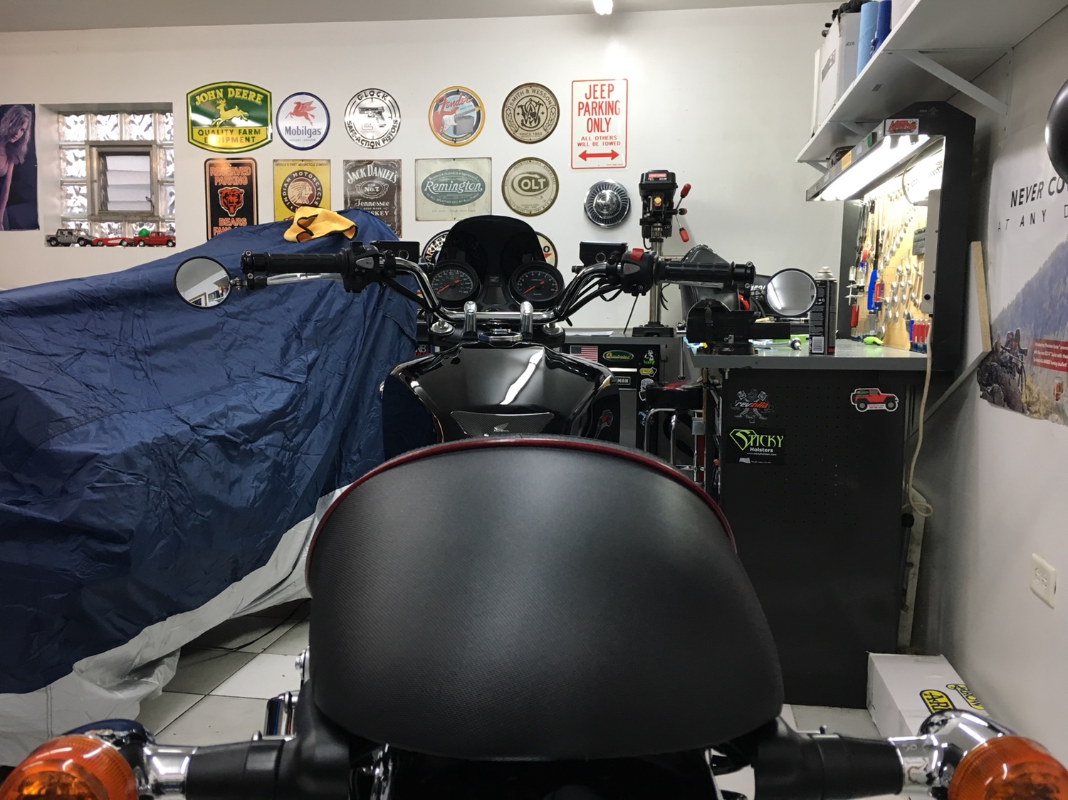

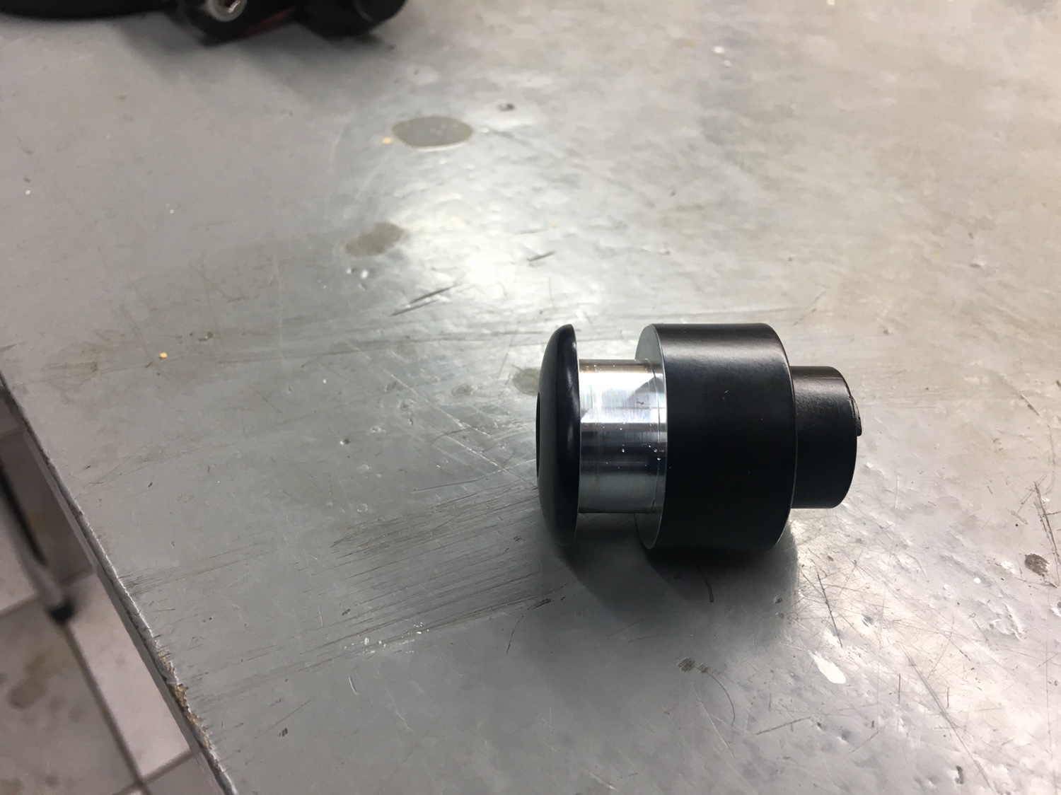

Hey guys , I wanted bar end mirrors but didn’t wanna lose the weights so per some info I searched on here I had a machine shop turn the weights to accommodate mirror clamps . Came out great and all stock weights left in place . All I had to do was paint the inside of weights due to them being bare metal after the work

W/R , I got the mirrors from Revzilla . Didn’t wanna screw around with cheapie mirrors so I went with the CRG lanesplitter mirrors. I have them on my Enfield as well and if they hold up to that paint shaker the CB is a piece of cake lol

I picked up a couple CRG arrow mirrors to mount on my bar end weights, I love how they look. Only problem I have is the weights spin in place even with that long bolt tightened down all the way. I haven't seen any body else who has had the weights machined to accept the clamp mention this issue. So at this point I feel like i'm doing something wrong.
