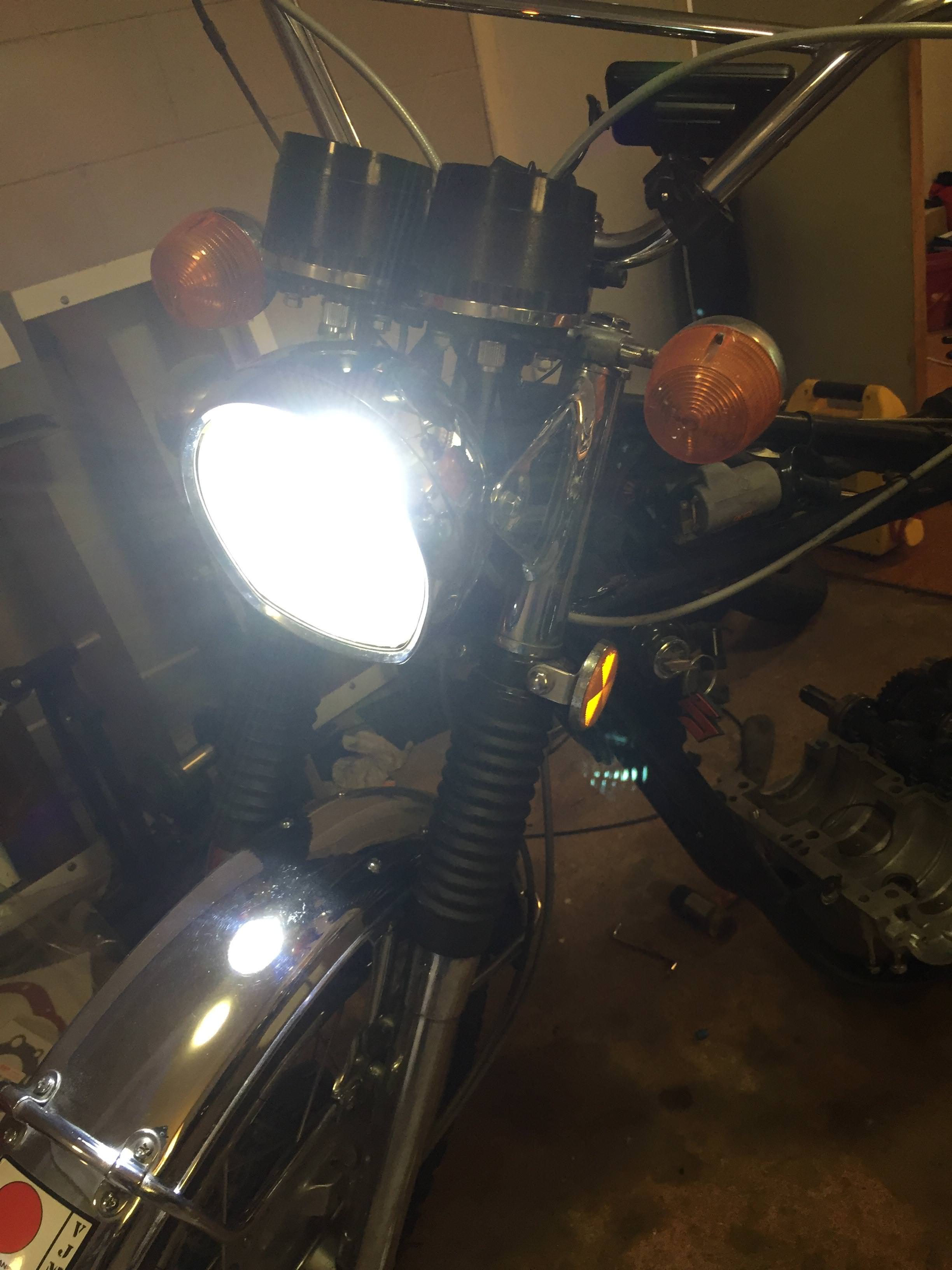

My old Suzuki T500 had a 35/35 watt headlamp/candle and was really scary riding of a night. i usually ended up tucking in behind a car and let them light the road ahead. I ended up installing a 40/40 watt led bulb in the headlamp and now I can almost see the koalas in the trees.I have even had car drivers flash me thinking I have high beam on. It was a snug fit inside the headlamp due to the cooling fan but after re-arranging the wiring it all went well. [Image: 1a79b5442d7948c4960abb07986b87b4.jpg]
