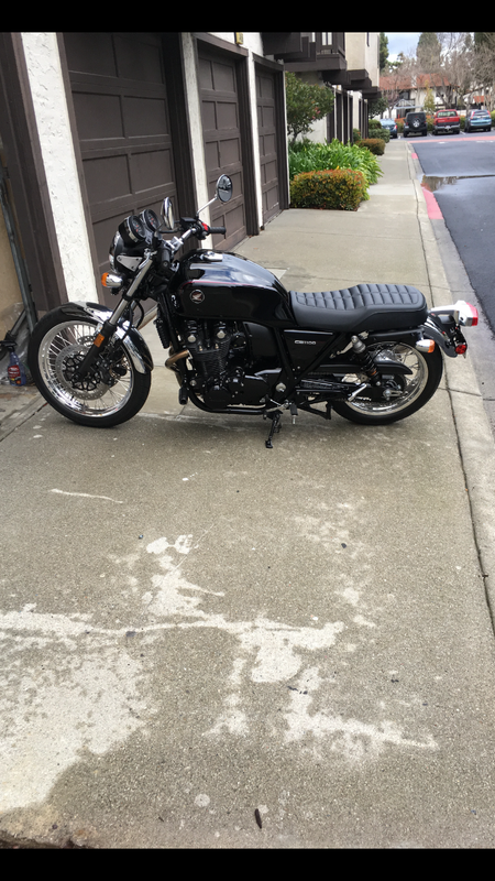

I took a lot of digging and research but finally got everything needed to put together the spoke wheels for my bike. I’m in the U.S. so everything but the spokes,rims came from Samurider in Japan. Samurider sells a complete kit but only in 18 inch diameters,I wanted 19-17 so put together my own deal. I got the hubs and all associated parts from Samurider and the rims,spokes and nipples from Buchanan’s Wheels and Spokes. Everything bolted right up with no drama,grief. Price,very expensive,the hubs alone were $1500.00.One thing I found a little odd was the dealer only has info,part numbers for bikes sold in the U.S. and nothing sold outside the Country,any info I needed all came from Samurider or outside in he U.S. [url=https://postimg.cc/rRyf0xzf][Image: 0d9ae6ea00ca23ea834e374fc4d84b4d.png]
