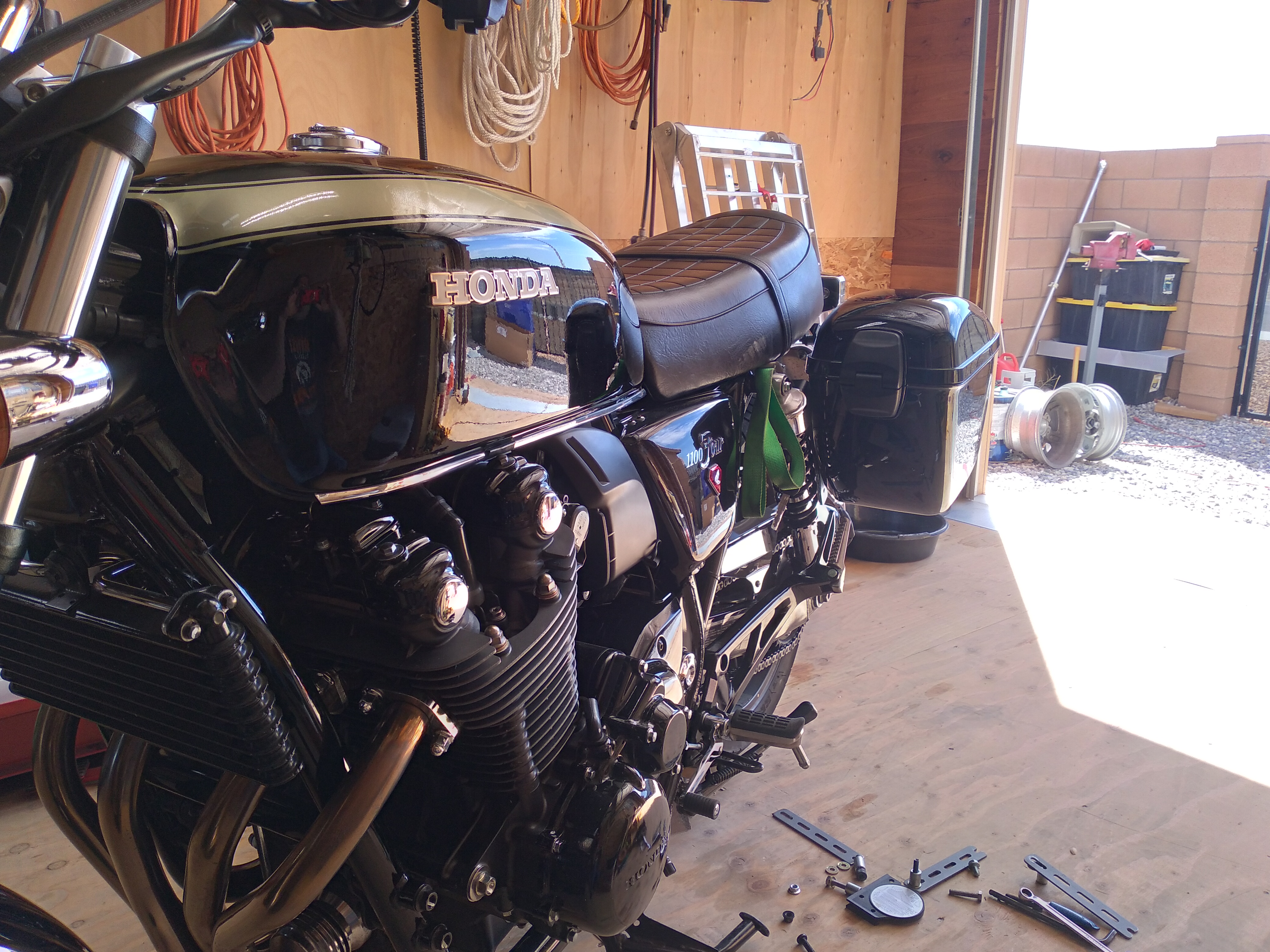

i remover grab handles and turn sig. at the connectors i found connectors with pig tails at cycle gear on line so i do not cut up stock lights

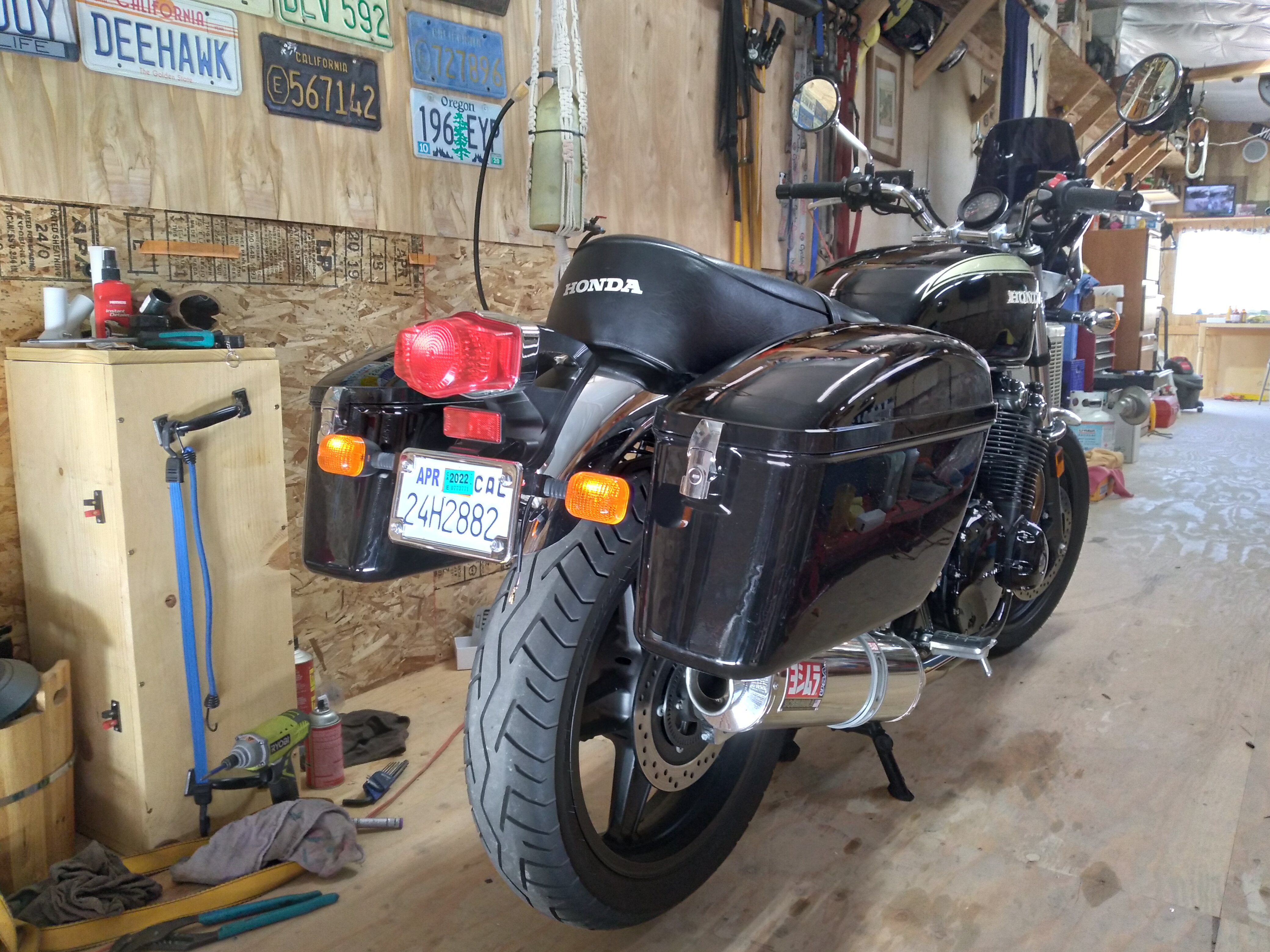

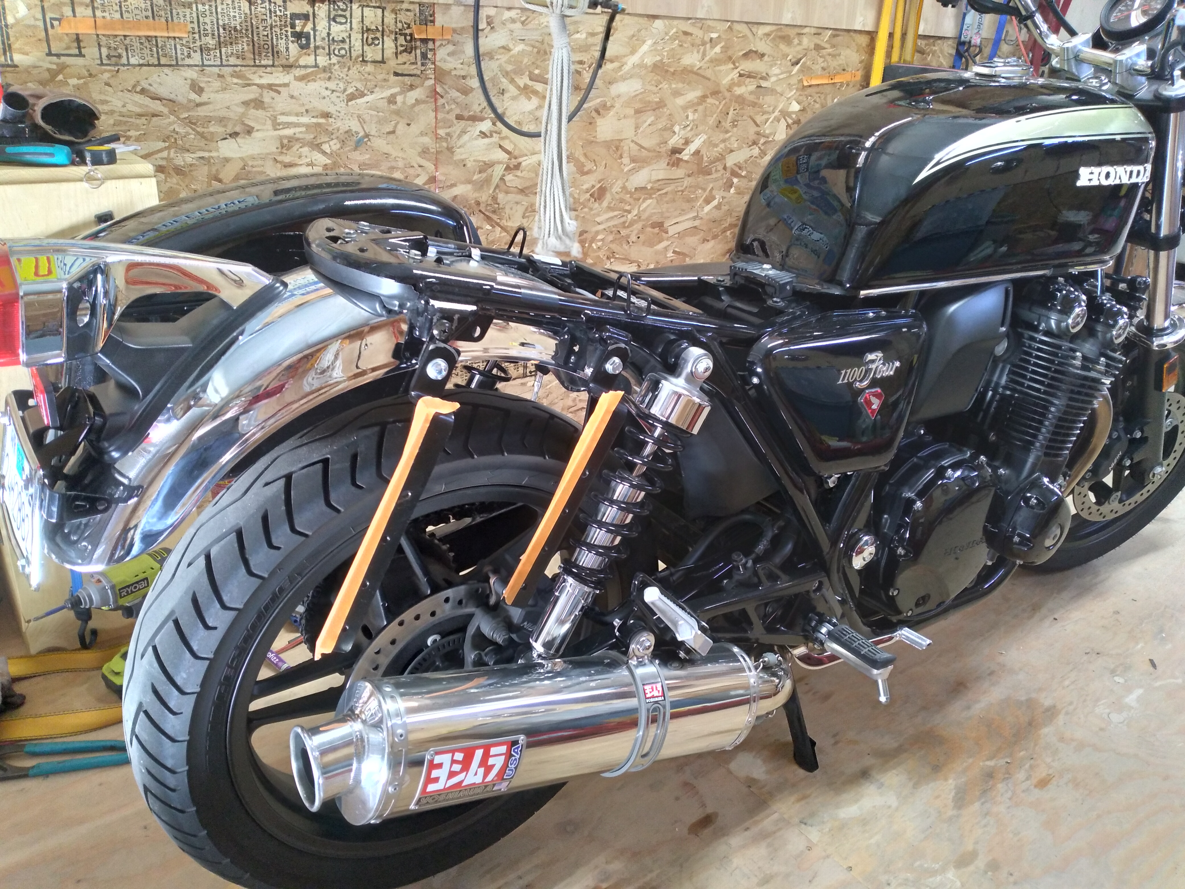

i used the brackets that came with the bags they bolted on to grab handle holes at front and the whitehouse adaptor at rear. they have a dog legs that lets them clear the chain Gard i bent them out just a bit to let the bags sit level they still need to be curved a bit to fit the shape of the bag
i remover the old reflectors and used the dremal to open up one hole and used an old set of lights that look like mid 80s honda
on the right side the bag just misses the pipe, although i like the sound of the yoshi. not so found of the looks. looking at an 18in reverse cone from Cone engineering
the whitehouse adapters are a bit bendy so i get some 1X1/2 flat stock drill and tap 2 new ones now i can remove it all and find matching hardware.

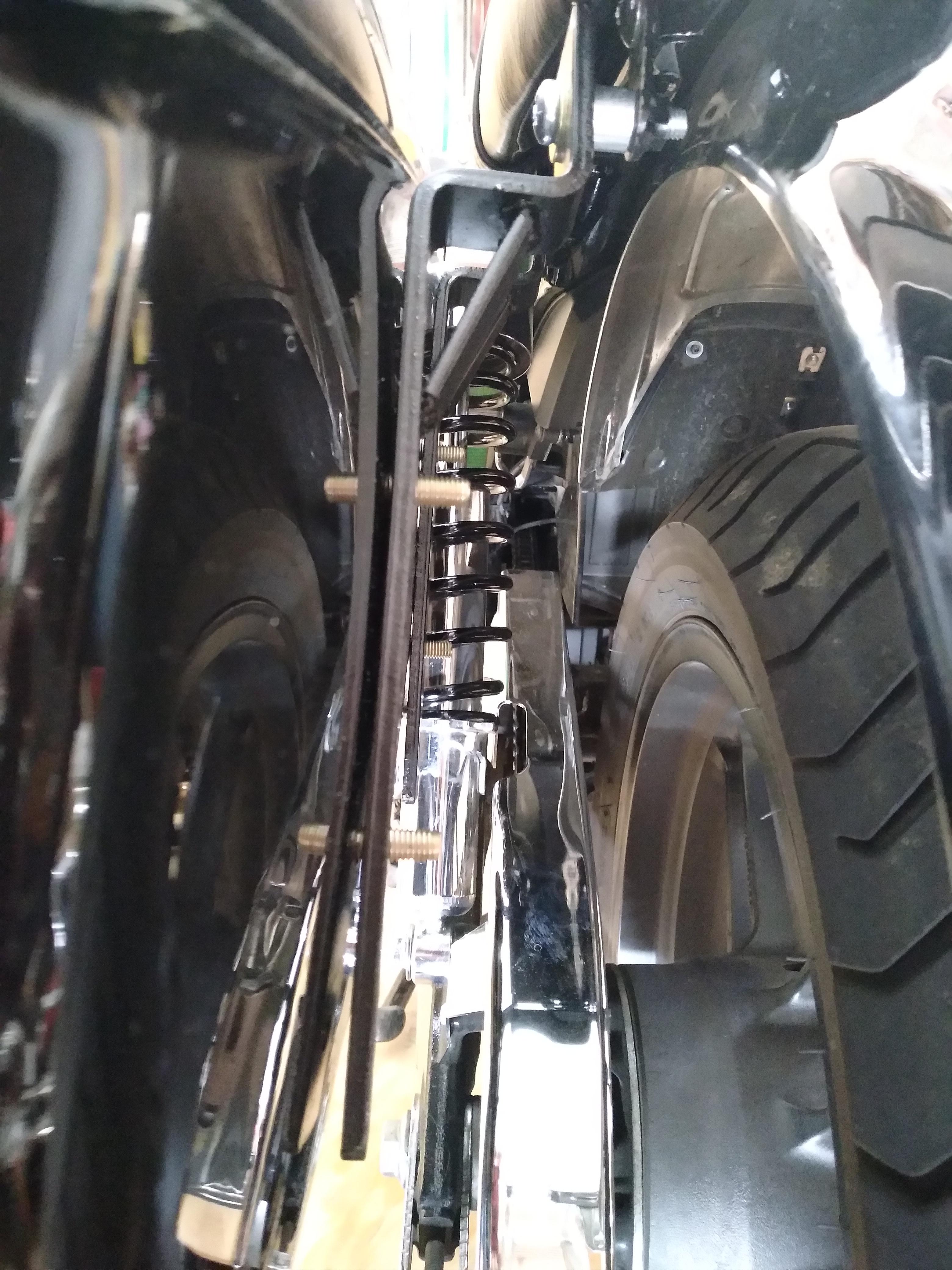

so when you remove the grabe handles you have no way to lift it up on the center stand. i have been using a sh[Image: 29ed8c83ea60ab53243af93b919f995d.jpg]ort [Image: 06ff4487c605693bd8941ea6a0f234d6.jpg]strap aroun[Image: 4e6d1ec8cd6fa478df95422139844b74.jpg]d the shock[Image: ead8bb1a3fcf82704b52eb01422d5e71.jpg][Image: d0a9396a82c73300eb17be6bfe01a98e.jpg]
2ed photo shows how the mounts need to be bent to fit the shape of bags

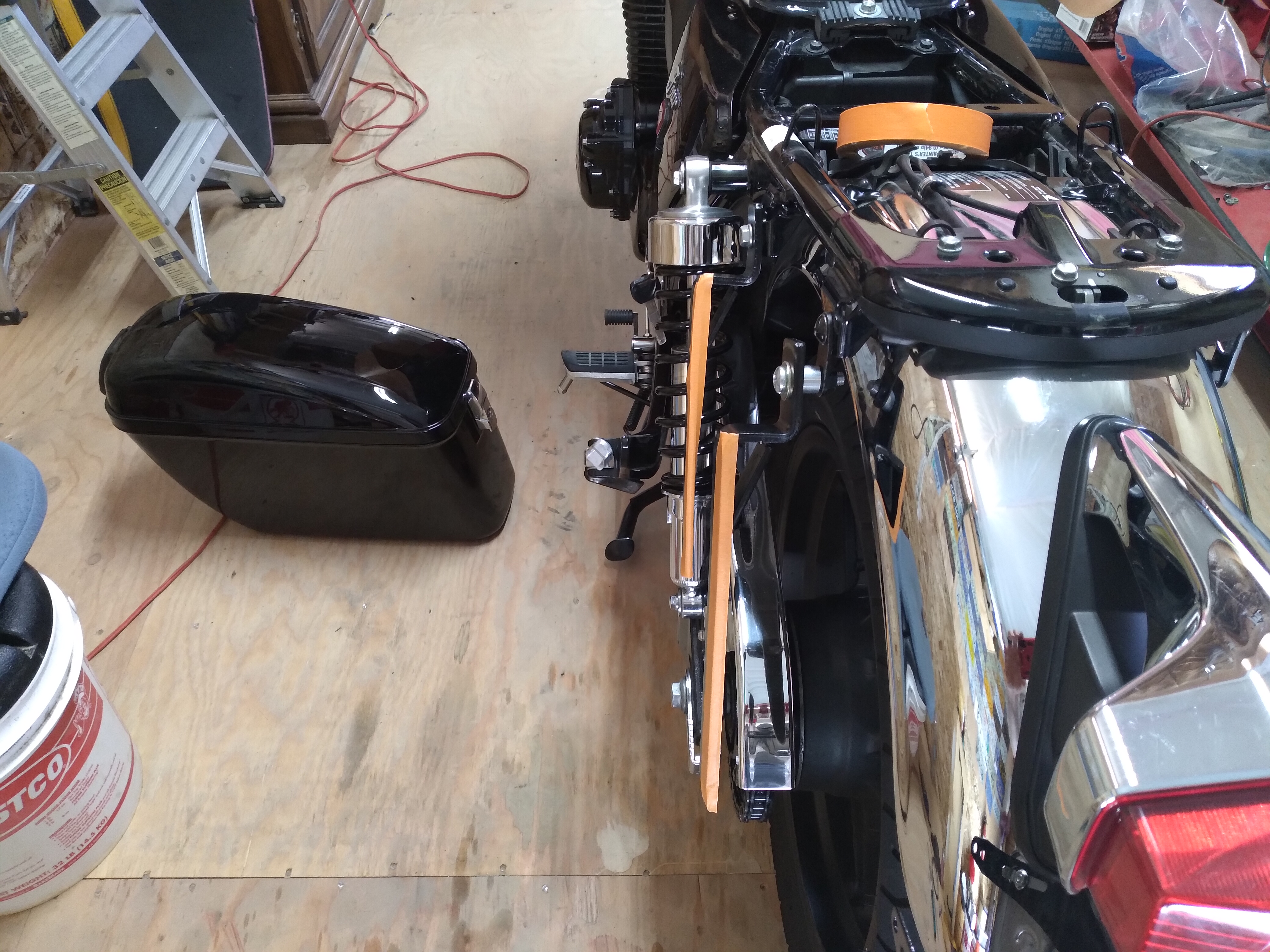

5th photos shows spacer on the rear mount to keep the bags lined up with the frame so rear of bags do not point in
Looks great! Those are rhe same bags I've been looking at Smile
Them bags look good on the CB1100.
