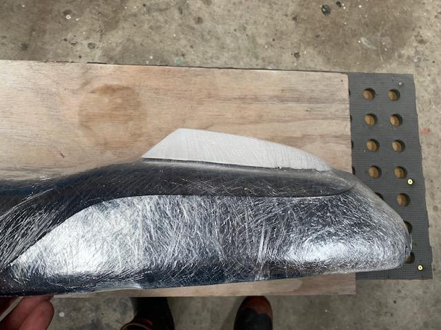

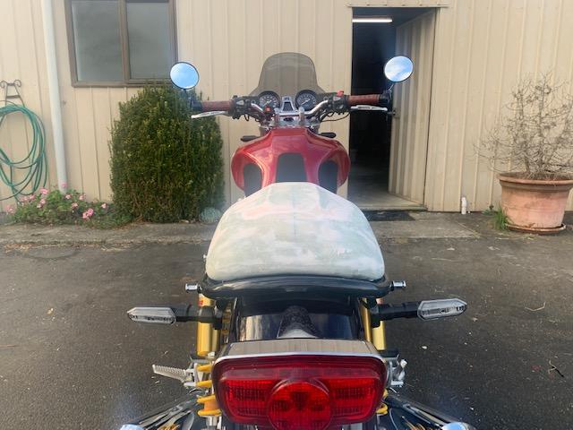

Hi all, I have been looking at the bless r seat cowl recently, but I am too cheap to spend $500+ and too impatient to wait 3 months, so I thought I would have a crack at making one.

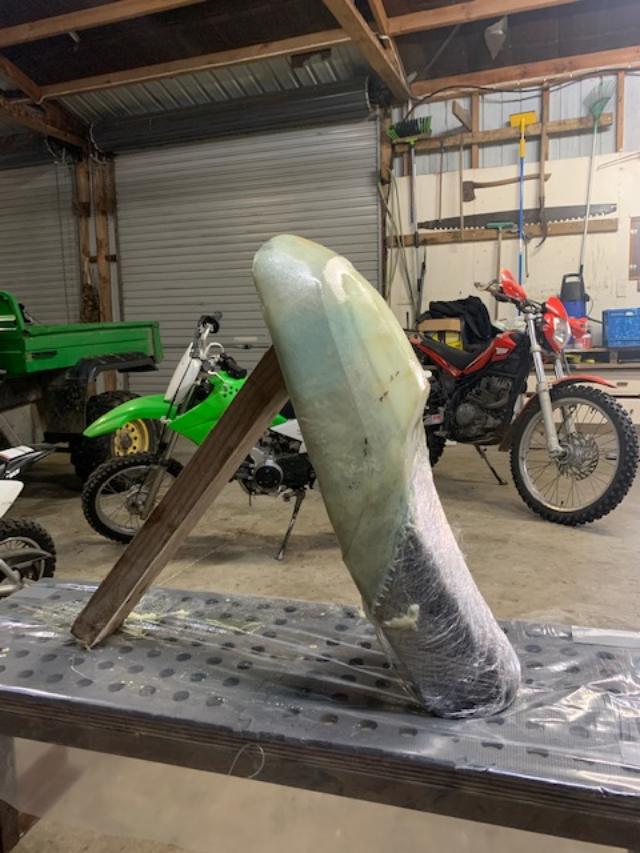

I have never done any fibreglassing before and I had a failed attempt at making a mold, so I thought I would use the seat for the mold.

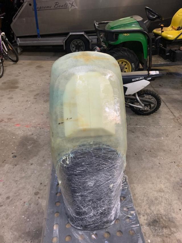

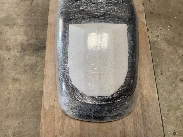

I covered the seat with glad wrap, and glued a couple of pieces of polystyrene together which I shaped to make the hump.
I then glad wrapped the hump to the seat and glassed over it.
Once it is set, if everything goes to plan I will be able to get it off the seat (fingers crossed), bog the crap out of it and paint it and it will look halfway decent.
Or I might have to cut it off the seat and throw it in the bin Confused
So far it looks better than I had hoped, there is three layers of cloth on it, I am planning on another layer one I get it off the seat, but I have no idea what I am doing and am just making it up as I go. Maybe it will need more layers?
At the end of the day, as long as I don't ruin my seat I will be happy...
Couple of pics

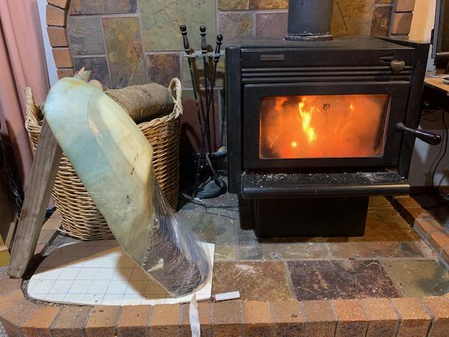

Its now curing by the fire!

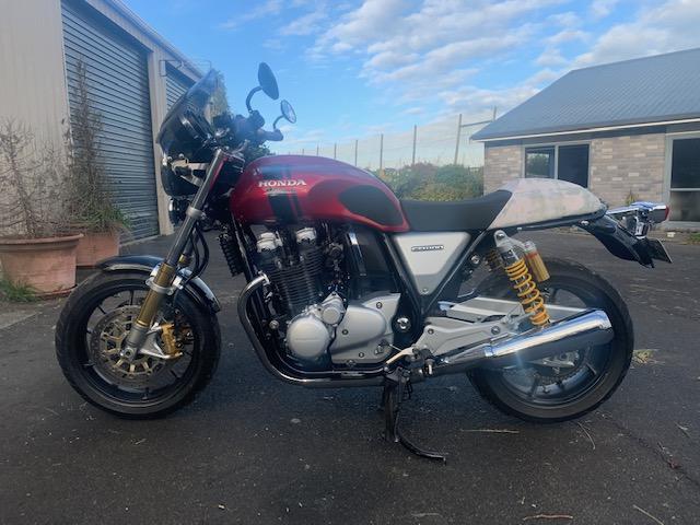

Actually quite like the shape of the cowl, better than my corbin.
It depends what grade of glassmat u are using, 2.5 to 3 mm. should do it and if it breaks it can always be repaired from the inside, from memory it has to be sanded for a good bond after the first layer has cured, there is a waxy finish i think that prevents a good bond, it has been a while since i have done this but that's what i remember.

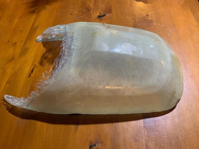

Thanks for the tip on sanding between layers. I just pulled the seat and everything is looking good so far, it needs a couple more layers of mat before I take to it with the bog.

I hadn't considered leather or vinyl, I saw a red RS with a red cowl on Facebook and liked the look, so that's what I had in mind.

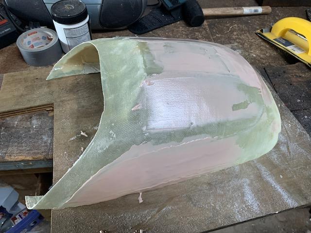

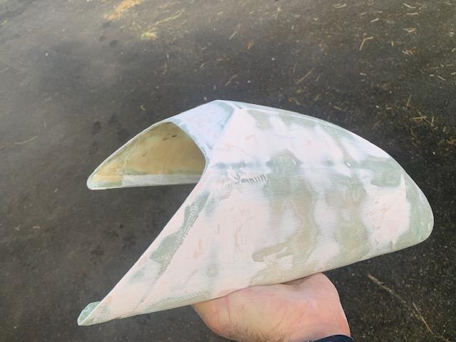

Progress update, I am really happy with how things are going so far.
I filled a couple of bits and then sorted out the lines I wanted, and cut it down to closer to the final size.
[Image: 2680e99bc1a02acf0c88c5639fdc4ec6.jpg]
[Image: 72a75c200a032f6ef6d9885598d8471f.jpg]
[Image: 5fd2441cf0df16e120d37ec7432976c6.jpg]
Then I put three more layers of glass on. I displayed my ignorance by purchasing chopped fibre mat, which is supposed to be used with polyester resin (I am using epoxy resin).
So I couldn't use the mat and had to use scraps of the glass cloth I had left over.
So instead of laying the final 2 layers in one piece I used multiple odd shaped pieces, which meant the shape suffered a little, although nothing that cant be sanded out, it just made a bit more work.
[Image: 246c0a411e3d99743630639f53543dc5.jpg]
It is nice and sturdy, I dont think there is much risk it will break.

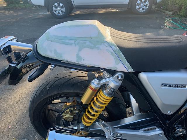

[Image: ae2b1da8d28be2578c266ad998952f10.jpg]
I like the way the shape of the tank is carried through to the cowl, its a bit hard to see with all the bog but I am really happy with the shape.
