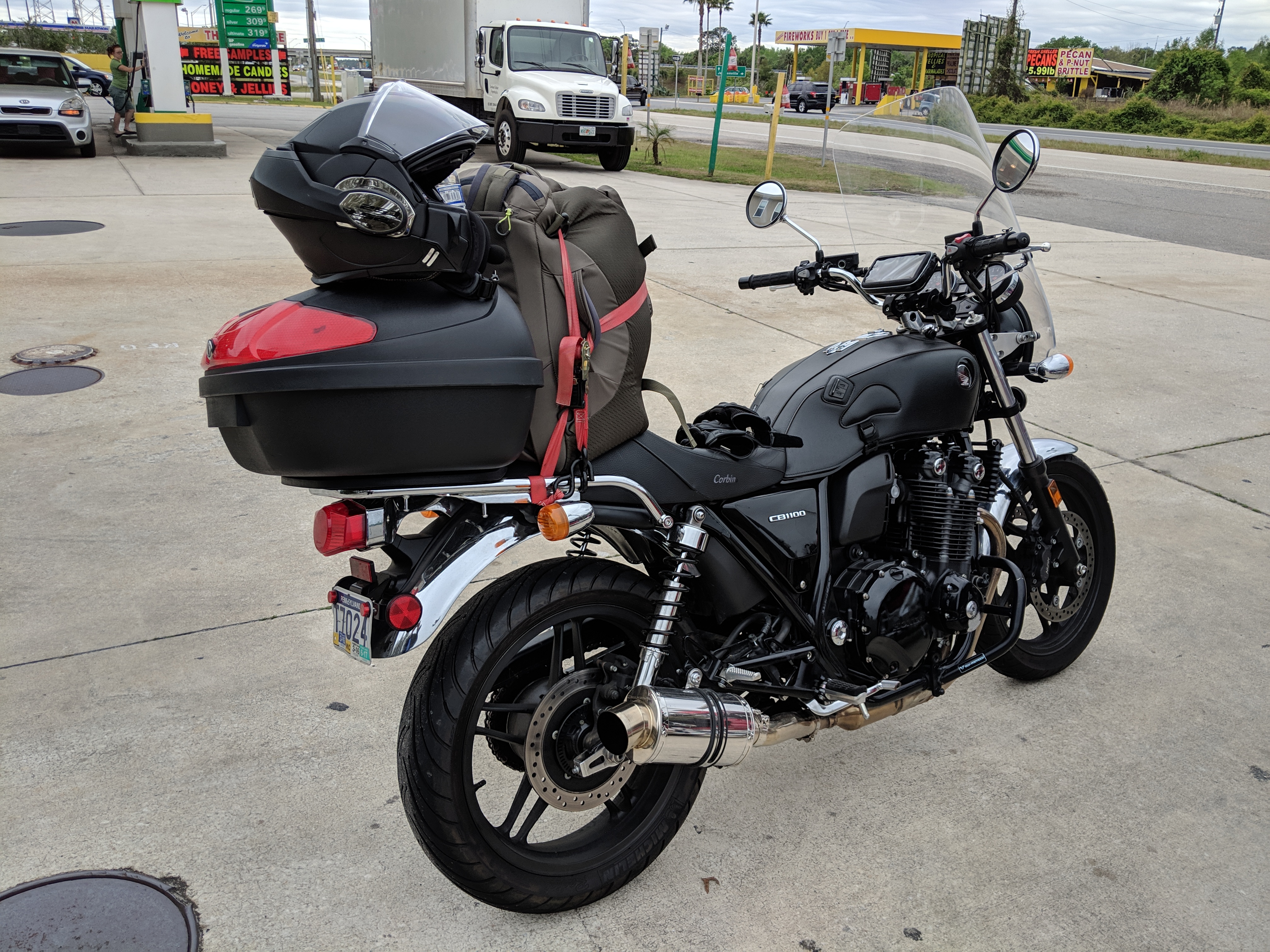

jeffmazz, I haven't seen a single backrest made for CB that had passenger comfort in mind. They are more of a compliance item, to help out in a pinch. They will keep your passenger from sliding backwards, but not resting.
I recommend you get a factory carrier bracket, it's nice and flat. Then get a quality aftermarket top box with a pad. Those are much more practical and the comfort pad is positioned higher, where it's actually useful. Most boxes like Givi or H&B are quick and easy to remove when not needed.
[Image: ed80f10b2f24f655ac40cb1f12048ac2.jpeg]
