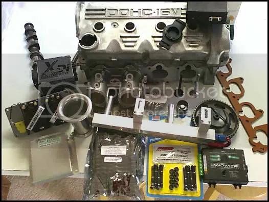

For fun- Here is what a shot of one of my projects over 20 years ago- of a 30+ year old car that I converted from an auto to stick shift, from drum brakes to disk, added ABS, added individual throttle bodies, added mechanical variable cam timing, added stand alone programmable fuel injection, aftermarket programmable ignition, aftermarket traction control …. and yea- I added a wide band O2 sensor … over 2 decades ago.
[Image: 0103691f169960126f18c495b1109397.jpg]
