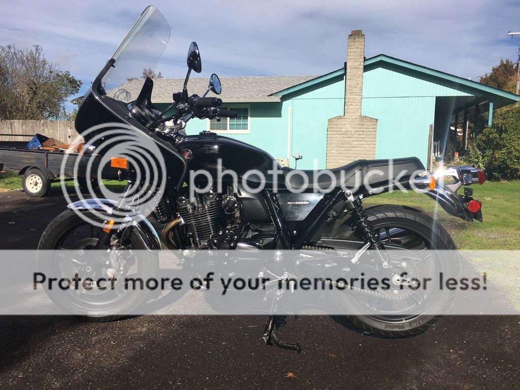

I believe you will be the third one that I know of that has mounted a Vetter fairing on A CB1100. Here is a pic of mine. It is a Windjammer lll.
Kevin
[url=http://s694.photobucket.com/user/husky385/media/Mobile%20Uploads/2016-10/4EADA4A4-BF8D-46C7-BEC4-495BA52D0A04.jpg.html][Image: 9c7e23317f38a0a3032ff6683d3ce0d7.jpg]

(06-04-2017, 07:44 AM)husky385_imp Wrote: [ -> ]I believe you will be the third one that I know of that has mounted a Vetter fairing on A CB1100. Here is a pic of mine. It is a Windjammer lll.
Kevin
nice - how did you get the mount up that high - it came with the mount for a cb550 - would not work for love or money - bought one from a GS1100 - looks like a better fit - nice look -
find the weight on the front end ok?

i found a kawasaki factory vetter fairing for free with mount - fellow bought it for a kz400 but didnt like it - with a bit of widening - and bending the top mount the top of the frame mounts to the oil cooler bolt - the outside tubes miss the oil cooler in stock position perfectly - just waiting to do the final install this weekend

Complete - used the mount from a Kawasaki/Vetter fairing - small mods for size - it works beautifully - no need to remount the oil cooler - used the top oil cooler bolt to secure the cross beam - fits a treat - noticed about 15% better fuel economy so far - and snappier top gear acceleration - less vibration in the bars as well opposed to the fork/bar mounted windscreen
