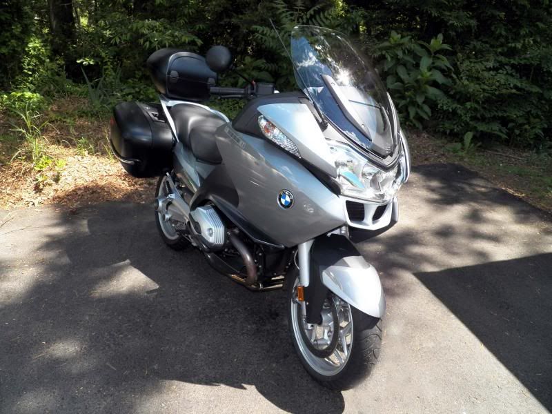

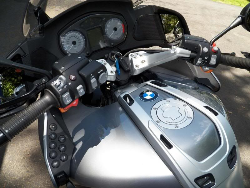

I fully understand this concept. I recently sold my 2005 BMW R1200RT with an electronically adjustable windshield. Being able to raise and/or lower it "on the fly" was great.
[url=http://s4.photobucket.com/user/Catbird1/media/100_0200_zps73d72de9.jpg.html][Image: e26508d63aca5f4b4224eeec196f58b9.jpg]
[url=http://s4.photobucket.com/user/Catbird1/media/100_0193_zpsd3f3a795.jpg.html][Image: 0b2e463236812e9305d1f202ea0c02c2.jpg]
