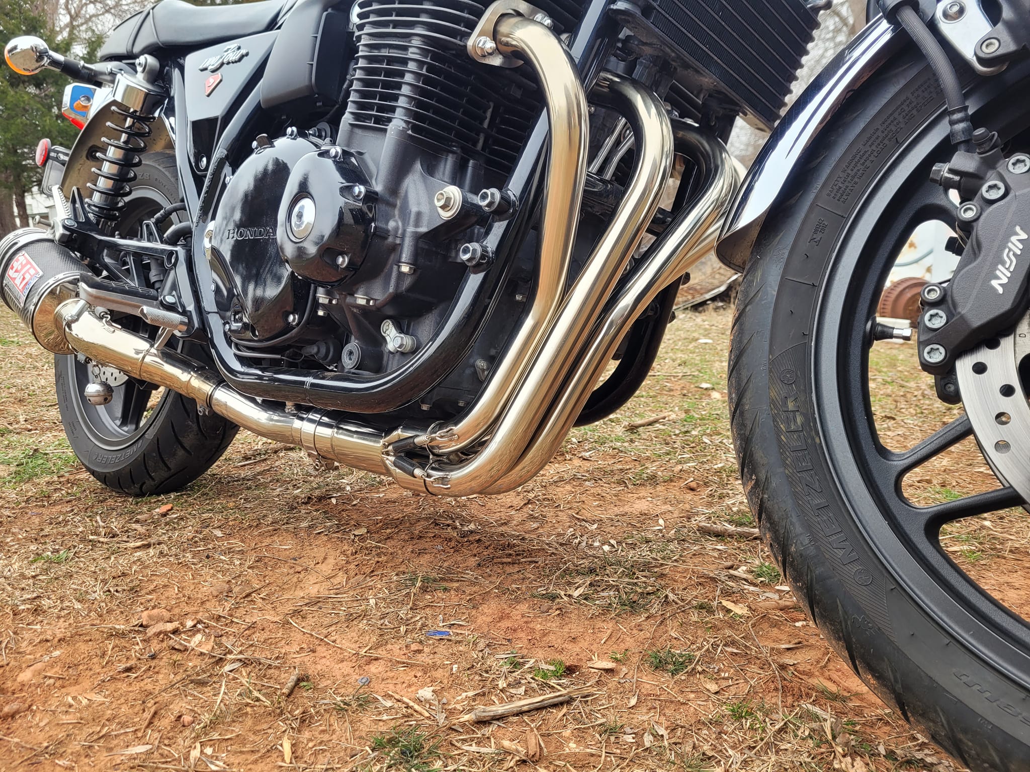

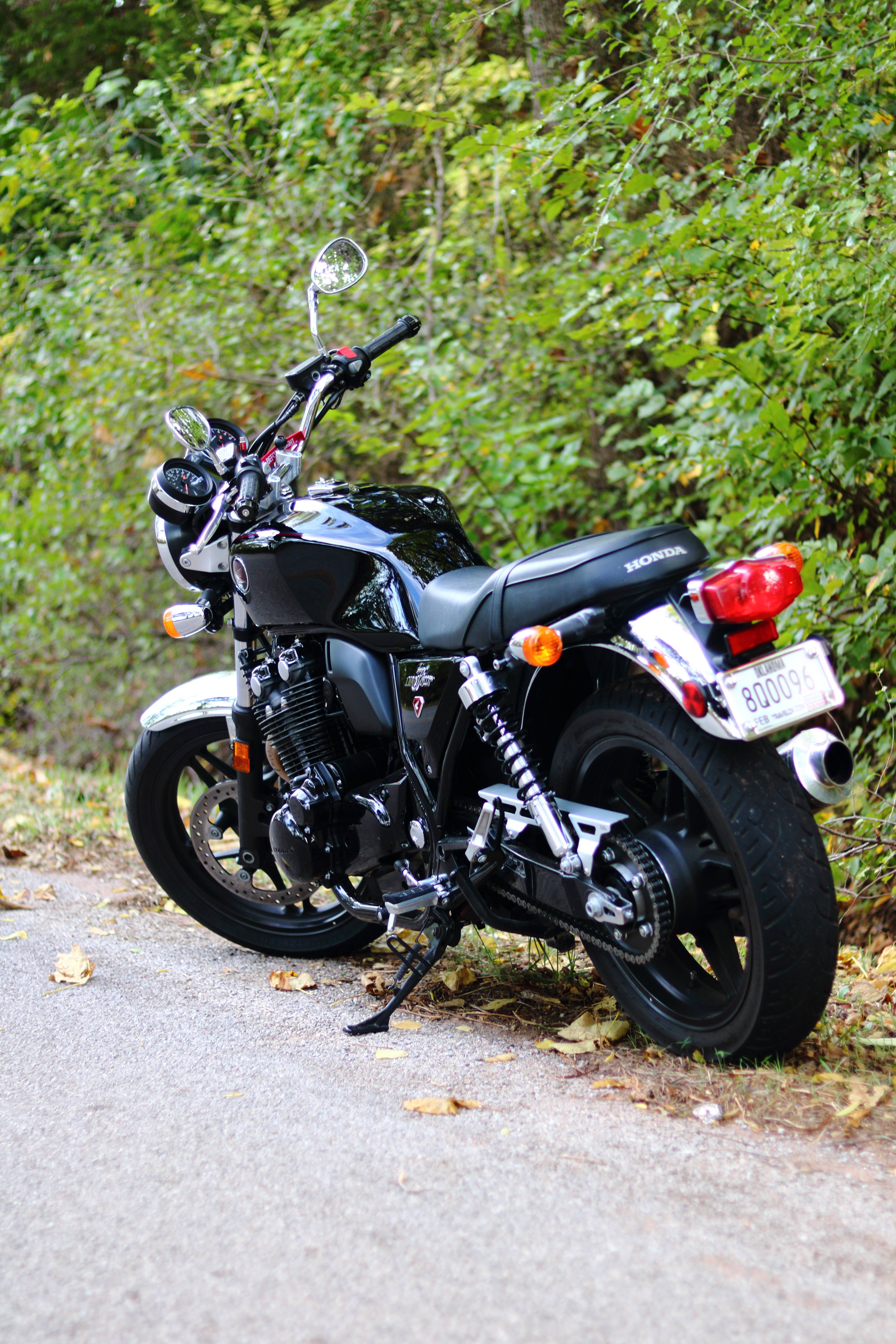

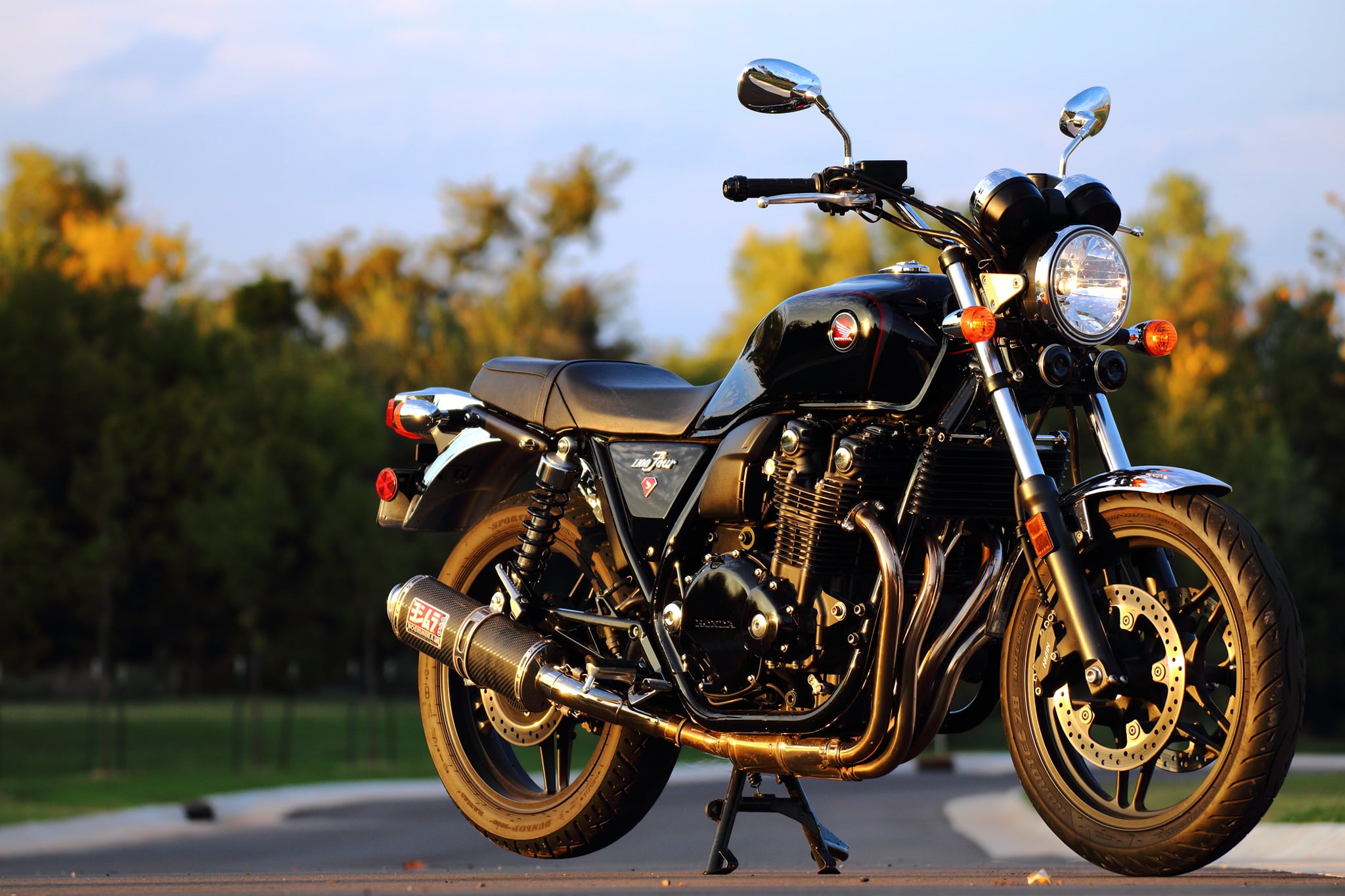

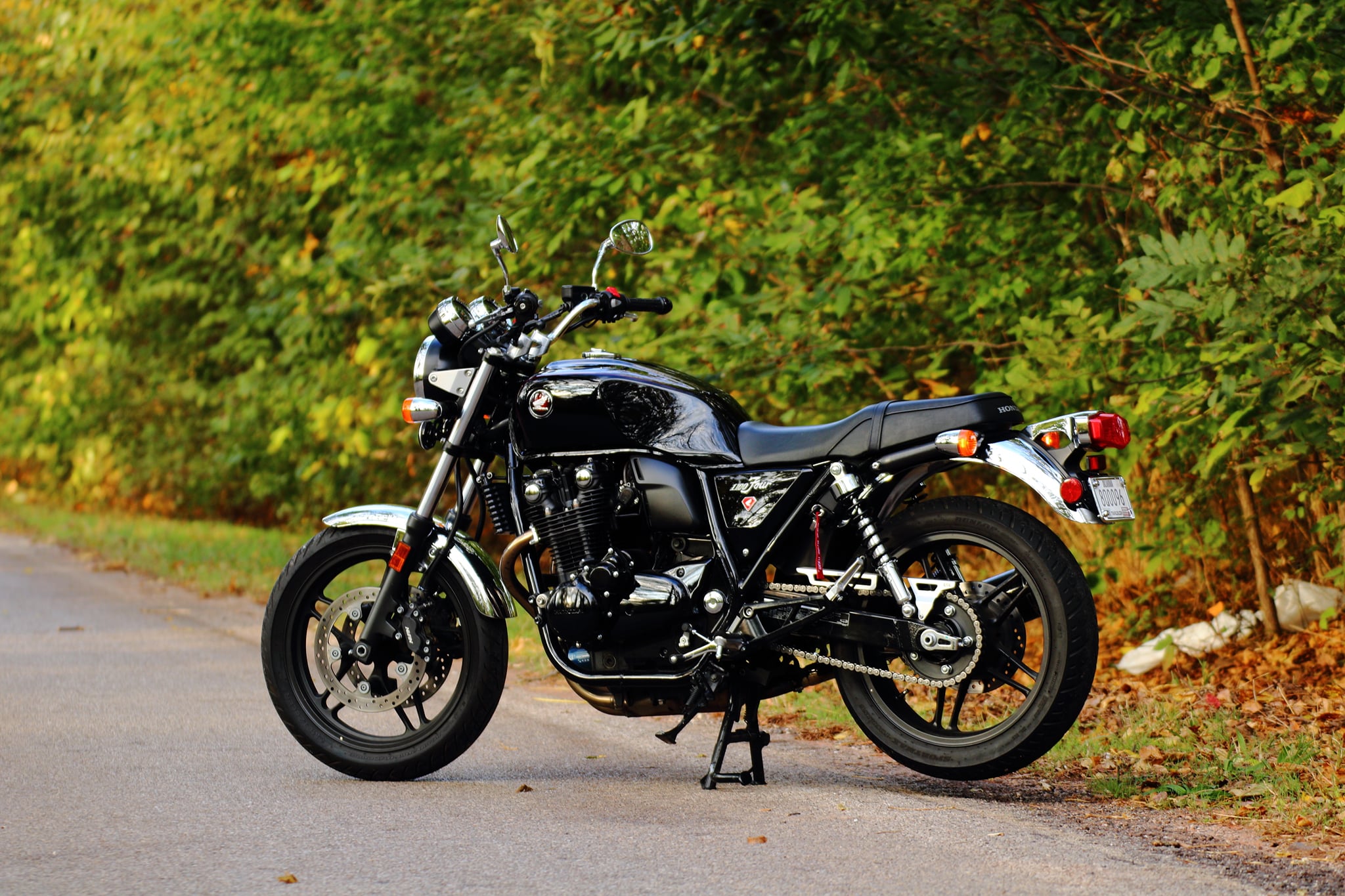

if you want more sound try a complete system the catalytic converter robs a ton of sound
try plasti-diping fenders as it is removable and redo able
mirrors are very personal choice i like my parts unlimited mirrors that mimic vtx mirrors i had on a previous vtx1300c
signals are another problem led will flash fast and the factory relay is not replaceable to my knowledge but resistors can be added
