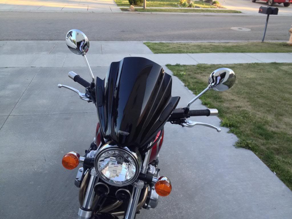

Photographs of my bike with Renthal Bars and MRA Sport screen.
[url=http://s225.photobucket.com/user/Rippington/media/image_zpsb2f77d4b.jpg.html][Image: f47312dc2f551d2a6131caf27b7ffd07.jpg]
[url=http://s225.photobucket.com/user/Rippington/media/image_zpsa554c7f9.jpg.html][Image: b8b6e28b2f4a855eb33e9f1e7374ffb6.jpg]
[url=http://s225.photobucket.com/user/Rippington/media/image_zpsc5b079b7.jpg.html][Image: 44fa4e73432879f1794654cb627cbce9.jpg]
[url=http://s225.photobucket.com/user/Rippington/media/image_zps894b7b3d.jpg.html][Image: 40206ed612a8bc8cee545db63f21dad7.jpg]
