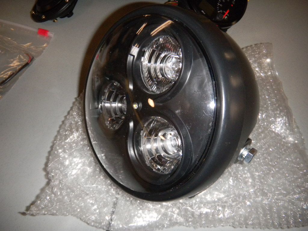

Plenty of LED headlights available. Look for one that will fit/replace the CB without too many adapters or spacers. Here's one I'll be using for a CB350 cafe' project. Low beam is the top light, high brings all three on. Each draws an advertised 3 amps. I bought it through eBay, but they're available from various vendors.
[Image: 4ef52cbe91126359a4c966fe9ffc53bf.jpg]
