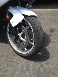

Not a CB1100, but I rode on this for 80 miles, at speeds up to 50 mph, and had no issues. The tire wouldn't hold more than 20 psi but the ride was smooth. No vibration.
[Image: 9c325d790d5d55faf397b59d1d171b65.jpg]
