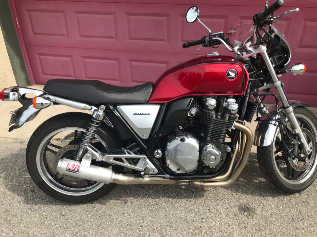

I’m 5’7 as well and had an inch taken off the stock seat. Here is a pic. It definitely helped!
![[Image: 045b6e090b1fd9bf7f78bb384d2fb29a.jpg]](https://cb1100forum.net/forum/uploads/imp/201804/045b6e090b1fd9bf7f78bb384d2fb29a.jpg)
