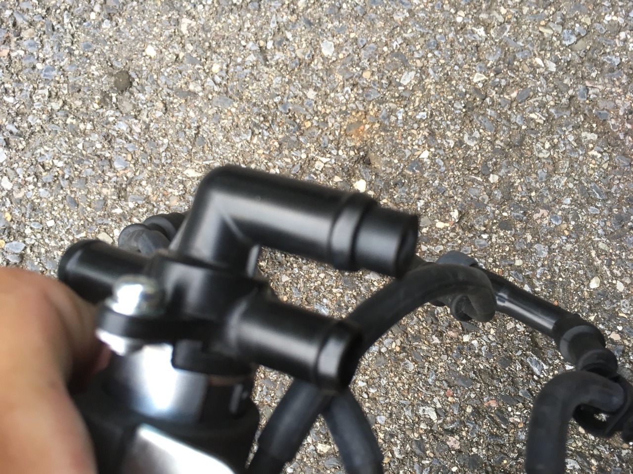

I took a picture of how mine is blocked since I had the bike apart.
Real easy, just used a vacuum cap plug, popped the hose off the solenoid at the front of the engine, inserted the cap, put hose back on.

I just removed the hose from the front of the airbox, stuck a marble in it and put it back on. I may have had to lift the tank a bit for access, as I recall.
Ben
