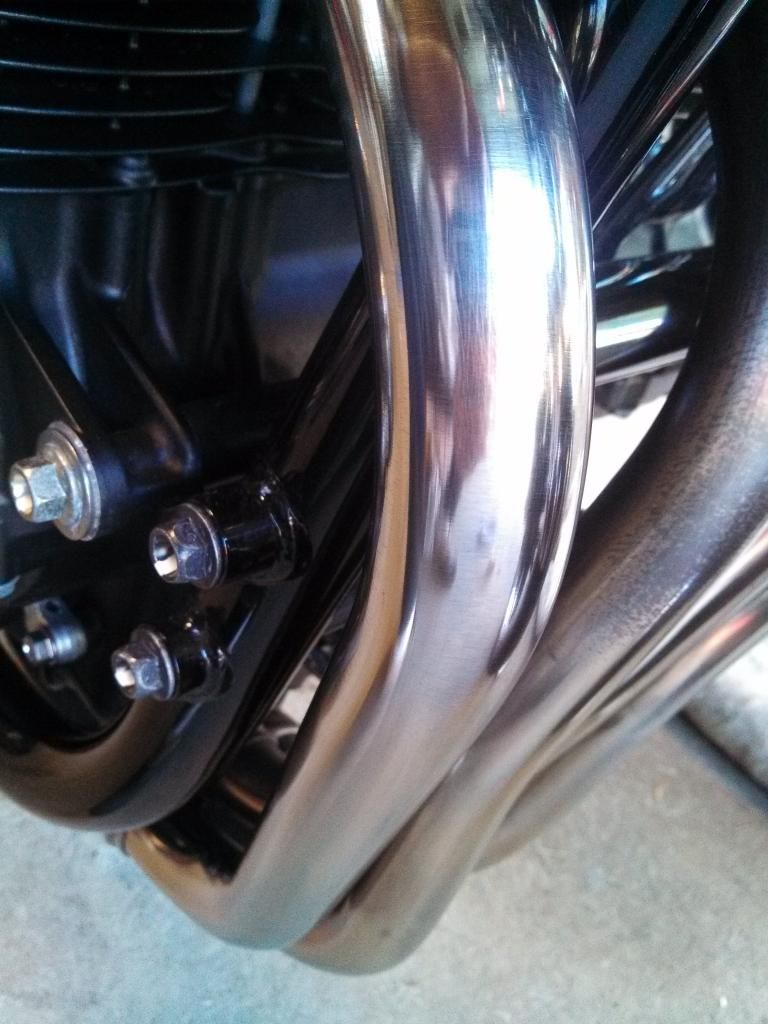

When I first picked up my CB, after about 30 miles or so I noticed what looked like someone had sprayed some thing on the bike and had got overspray on the headers. The headers were clean when I picked her up and she only had 3 miles on her. Today I picked some Mothers polish and tried it out.
[url=http://s974.photobucket.com/user/Mark_Betz/media/Headerspots_zps682bf81b.jpg.html][Image: bb612e2af43e3d5a3ff74ca083fc79a7.jpg]
After some elbow grease I was able to get them looking pretty good.
[url=http://s974.photobucket.com/user/Mark_Betz/media/Afterheader_zps2430c85e.jpg.html][Image: 14f1122935bea4c84d07b53696fa7a69.jpg]
Down low on the header pipes was a little burnt on crud, so I used a green scotch-brite pad lightly to get the crud off and used the polish.
[url=http://s974.photobucket.com/user/Mark_Betz/media/Headersdone_zpsd5892e77.jpg.html][Image: e6017043a9a0ce5cf3512926b4de0e99.jpg]
I'm getting ready to cruise around the roads here by the house. Will see what they look like when I get back. I know they will still turn colors, but hopefully the spots will not come back.
Hope this may help someone else out there. Thumbs Up
So, you used a green scotch brite pad on some of it. What did you use for the rest of it?

(02-16-2014, 12:27 PM)Ole_imp Wrote: [ -> ]So, you used a green scotch brite pad on some of it. What did you use for the rest of it?
Sorry, forgot to add that. Mothers Mag & Aluminum polish. "Very lightly with the green scotch brite pad". It took a couple of coats and changing up the cloth a few times with the polish.

To Clearify, I used the scotch brite first, by itself and then applied the Mothers Mag Polish with a wash cloth, After I was done I wiped the pipes down a second down time with a micro fiber towel.
