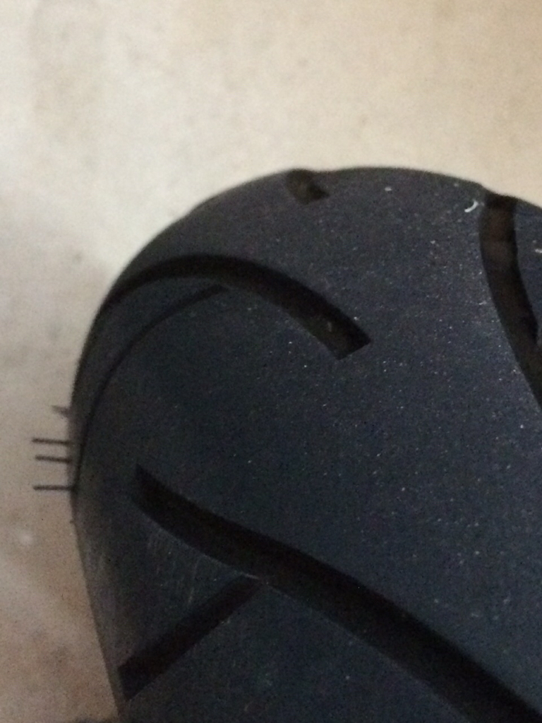

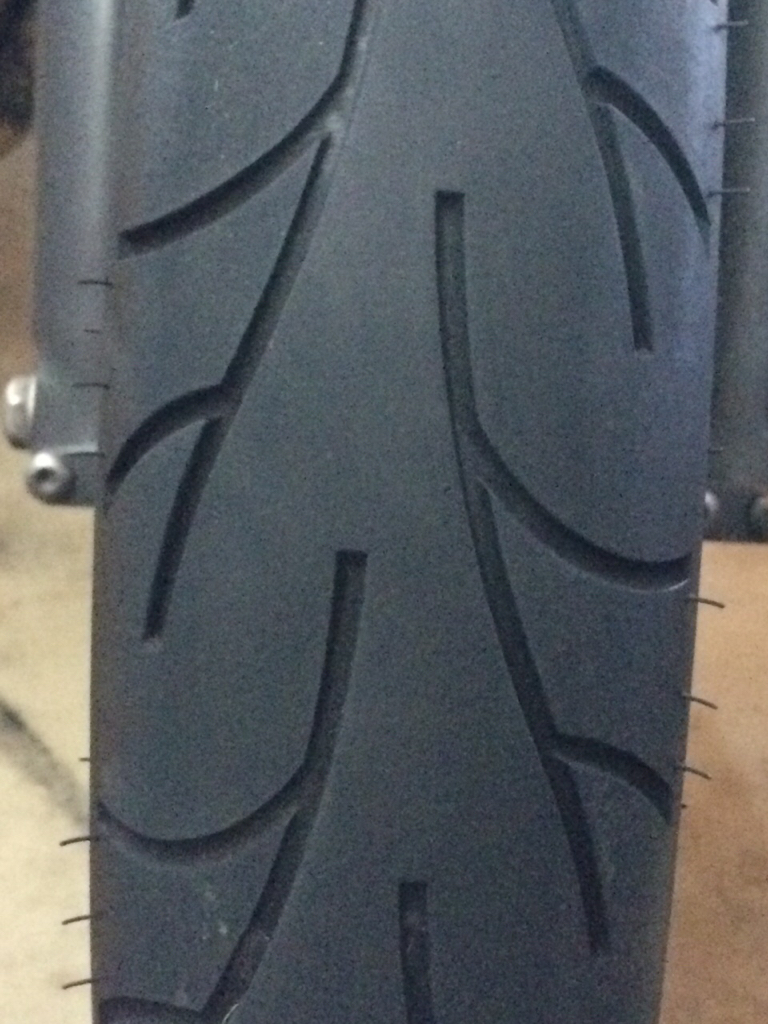

Starts coming on around 50, cast wheel, new tire about 4 months ago, had wheel off yesterday and had it checked for balance, it’s good, bearings good. Axle properly torqued and followed Honda service manual procedure to mount front wheel. Tire does have slight uneven wear from side to side. Always keep 36 psi in tire.

Further describe uneven wear.

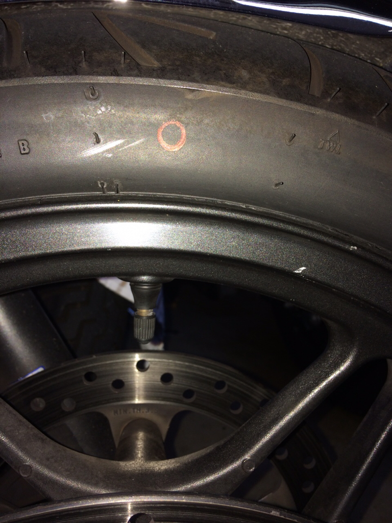

Valve stem dot/located in place although it’s off a little.

Tire "looks" fine to me. Swingarm bushings / bearings came to mind, but I don't know if this is a wear item like it was on the 1970's-80's CBs.
I love the Continental tires but your tire is a cross ply tire , would a radial be better ???
When I relaced the stock Dunlops at ~10,500 miles (8 months riding), the rear was replaced for wear and the front for cuppling. I did not brake hard, cornering was not agressive and tires were not underinflated.
If that were a rear tire, I'd increase tire pressue 2-4 PSI and then smoke it a few times.
But, once the wear starts, it is nigh unto impossible to halt.
Still suggest 38 PSI in the front..
