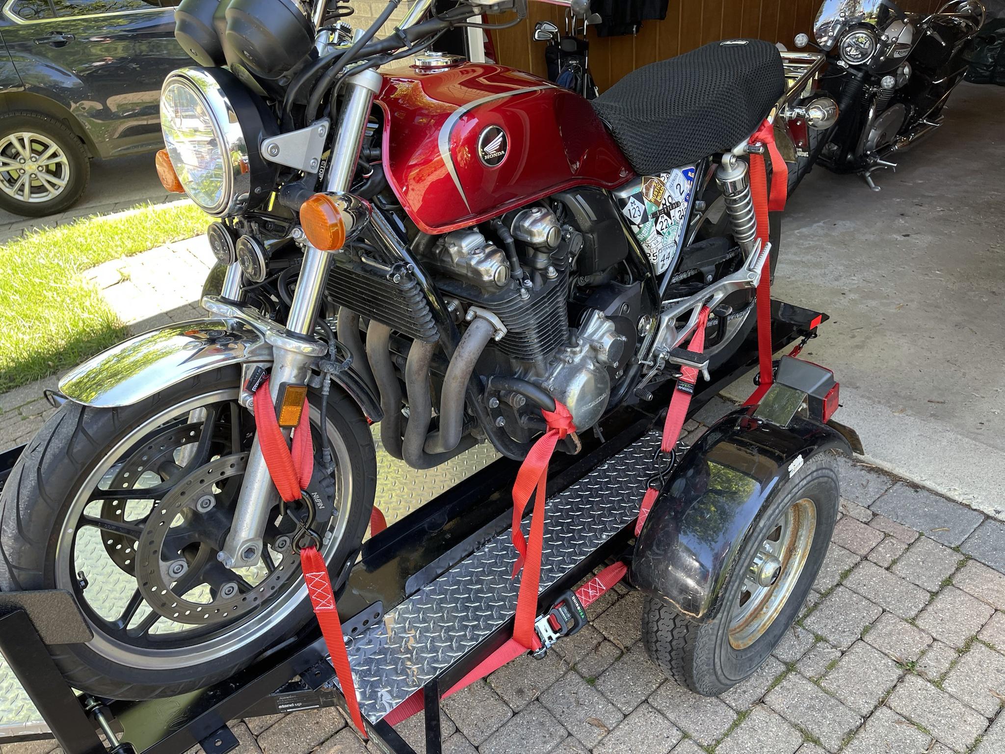

[Image: acdd1f9584bd6c5eba3551370055e46d.jpg]

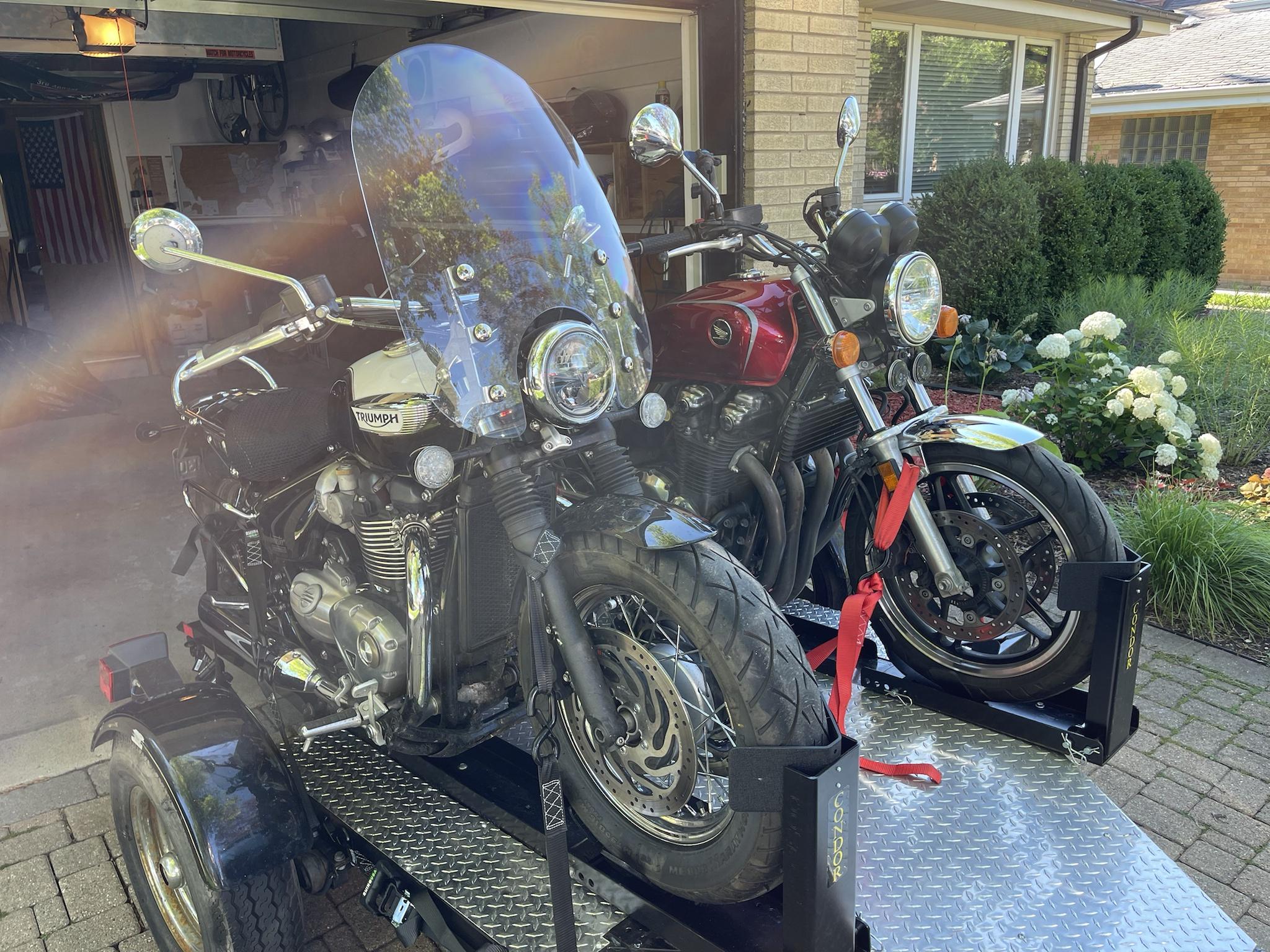

[Image: 8ee616a668b767580275ec0385e0fbd1.jpg]
You can ignore how I tied them down for these pics. The method worked, but I ultimately decided on 4 straps/bike all strapped to "unsprung" parts and all pulling the bike forward into the chock. Neither bike moved at all during their 1800 miles of travel.
