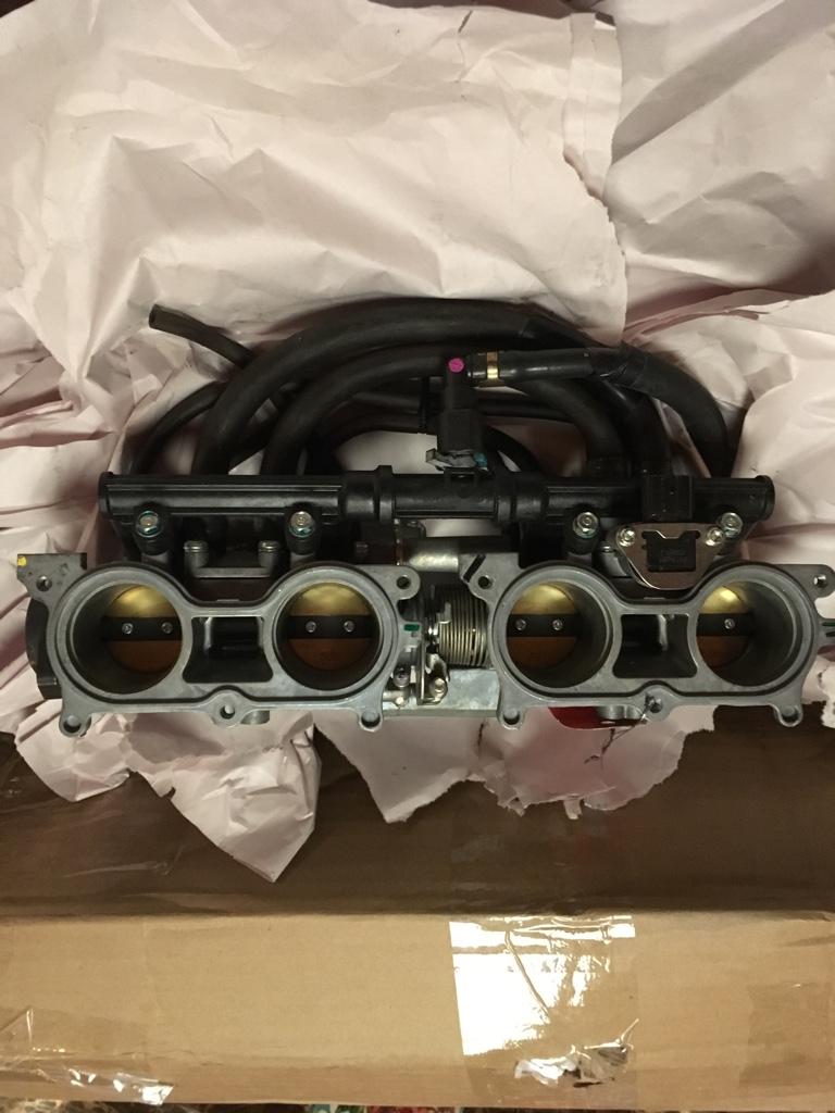

Next obvious bottleneck is the throttle bodies. The bike has 32mm.
I started to look around - knowing that a lot of motorcycles (and cars) use partsbin engineering to save cost.
Sure enough- a similar vintage CB1000 has TB that look the same in all the pictures, but are 36mm.
My guess is that Honda used the same casting with a different ID bore.
So I bought a set.
![[Image: 07e6998613ac1dc06af66b48d698950f.jpg]](https://cb1100forum.net/forum/uploads/imp/202011/07e6998613ac1dc06af66b48d698950f.jpg)
Came complete with everything- injectors, fuel rail, TPS sensor, other sensor, hoses....
So I went to the garage, grabbed my spare airbox, and sure enough- the housing/flange are the exact same and fit the mating groove perfectly.
So I bought a set.
