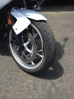

I hit a big honkin' pothole last month. I didn't crash but, according to Reddit, my wheels are probably trashed. After a lengthy and unresponsive battle with my insurance I need to just take care of this myself. I'm trying to figure out what I need to test (and how to test) and because the state of Virginia should pay for damages. I don't have access to a full shop but I'm relatively competent with a wrench.
Currently all I can tell is damaged: the front and rear wheels and the rear tire. I'm probably going to replace the front out of an abundance of caution. Here are some pics: (Front [[url=https://i.imgur.com/bwBfANA.jpg]1] ) (Rear [[url=https://i.imgur.com/45w9iae.jpg]1] [[url=https://i.imgur.com/8dAFlJ4.jpg]2] [[url=https://i.imgur.com/l89Zo9S.jpg]Tire Detail])
So far I've done ye 'ol wheel shake and it sure seems like the bearings are fine on both wheels. I gave it a short ride to test the suspension and it's working fine as far as I can tell (but I didn't want to push it). What else do I need to do?

I had a similar situation in Pennsylvania. Not sure which exact pothole did me in, but I discovered that rear wheel was so bent, the tire was slowly losing air. Found a used wheel on ebay for $150 shipped (directly to dealer) and paid something like $100 to the dealership to swap 'em out. Too small of an amount to even bother with insurance.
The state might eventually pay, but you will waste more time than its worth.

That tire is likely 9 years old, so don't use it.
You might try this: https://woodyswheelworks.com/
Woody’s Wheels can fix about anything and that isn’t really bad (for them).

(11-28-2021, 08:35 AM)LikeAfox_imp Wrote: [ -> ]I had a similar situation in Pennsylvania. Not sure which exact pothole did me in, but I discovered that rear wheel was so bent, the tire was slowly losing air. Found a used wheel on ebay for $150 shipped (directly to dealer) and paid something like $100 to the dealership to swap 'em out. Too small of an amount to even bother with insurance.

I honestly have no idea how my tire isn't leaking.

(11-28-2021, 08:43 AM)Lord Popgun_imp Wrote: [ -> ]You might try this: https://woodyswheelworks.com/

2013. I just caught a glimpse of them! I really like the black interior paint on my rims but I'm really tempted by your minty fresh bearings and spacer. I wanna get an estimate from Woody's on bending it back but I'll probably reach out to you tomorrow regardless! Thanks.

Glad to hear that. I've honestly been surprised that the places I've called are unable to bend it back. I'm hoping Woody's can give me better news.
