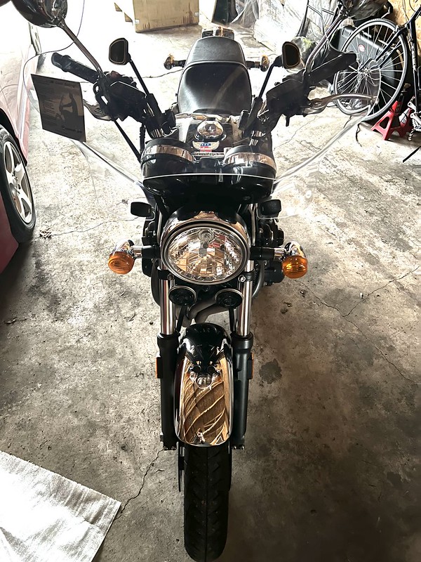

I've used a level and all contact points are good, so maybe they are just out of rotation after further thought. I've also loosened and shoved the forks which seemed to help the alignment slightly.
Here are some dark photos. * I really need some LED Garage lights *
[Image: 5bc3bdfb58d17b5778e69b49870cdf81.jpg] [Image: 1f6a2bbc5e2a131e0b8f81727771f61d.jpg]
The 2nd photo really shows how misaligned the front is. The wheel is at an angle compared to the rest of the front end. Lights & handlebar and the other things that stand out to me looking at it.

Really hard to tell anything from the pics, but say, a set of wire wheels would probably fix it all. In fact there's a set for sale on the Forum.....
Seriously, I would replace the handlebars first, just to have a baseline. Without straight bars, everything will seem a bit wonky.
Does it go straight down the road, or does it pull to one side or the other?
She rides straight, I haven't noticed any real pull.
It is hard to tell what is actually out of alignment since everything just looks off when I look at the bike.
