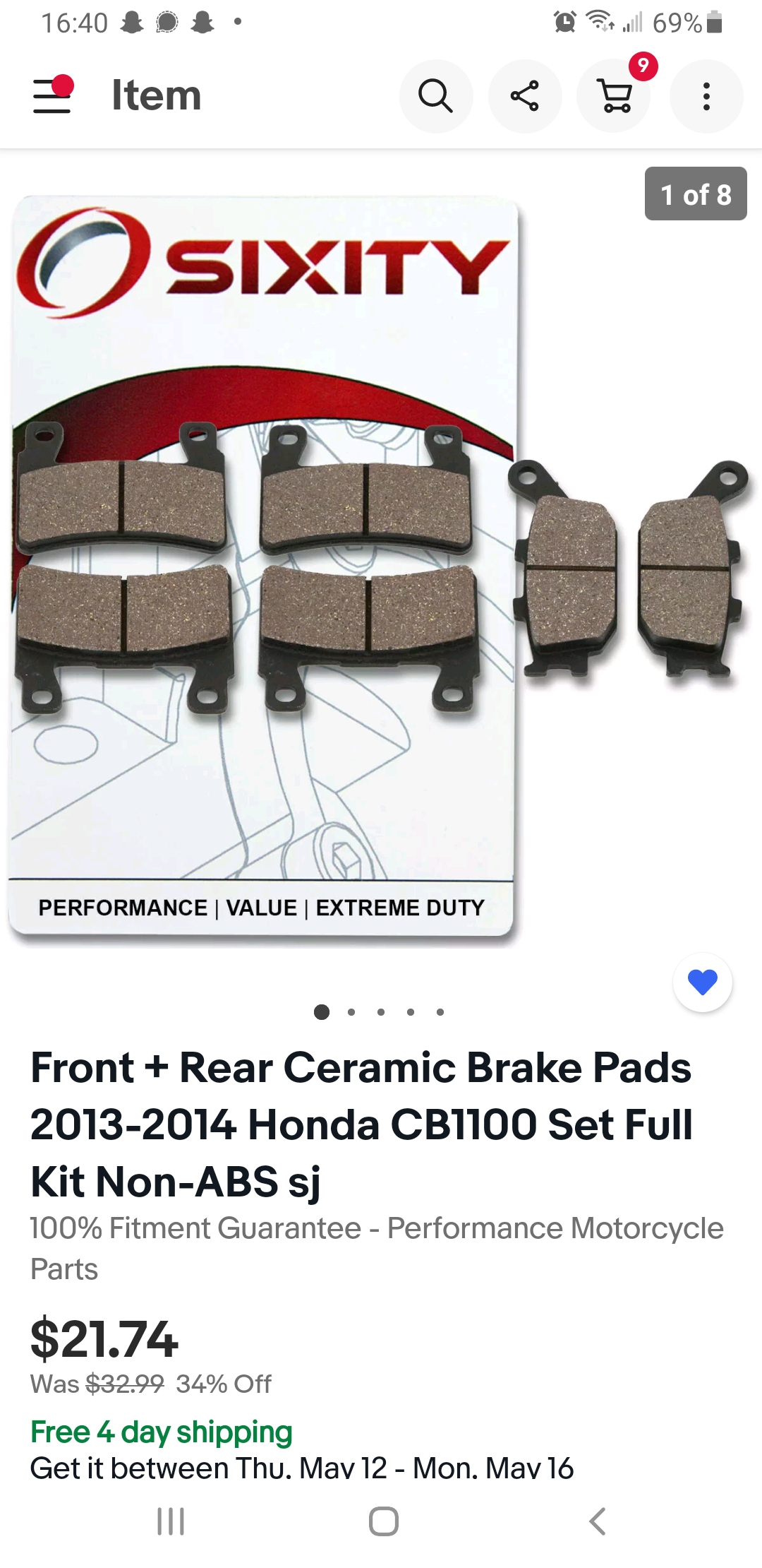

I've seen a few "Brake Pad Threads" but didn't see anyone mention using ceramic pads.
I see that brand "Sixity" pop up on other forums as being the "Ebay special" but anyone that's gotten then said they were OEM spec and loved them.
I see they have a sale on ebay right now and have a full set of front and rear ceramic pads for 21$
And a full Sintered set for 41$ thats usually in the 70s
Also organic pads for 17
Now before you say it i usually don't give the ebay special brakes any credit but my Google search has guys from kawasaki forums and HD forums etc back to 2010 saying the brakes worked great for them and lasted thousands of miles. Sixity website also looks legit, they have a warranty, and they've been around for a decade or 2
https://www.sixity.com/search?q=Cb1100+motorcycle
SO brand aside, has anyone used Ceramic pads on our CBs and liked them?
I already changed rotors once so I'm drawn to the ceramics being less wear on rotors long term.
I have no complaints on the OEM pads stopping power but I'm not sure if our OEM pads are organic or sintered?

Our front and rear OEM Nissin pads are GG rather than HH rated so I would guess the Ceramic will be more akin to the original GG's. Traditionally GG's are recommended for the rear to allow for a better feel under foot even if you run HH's at the front. I do run Brembo HH's all round as it happens and get on with them well. Not for $41.11 though!
As to the brand, I can't personally comment, you seem to of done your research. Every brand is fallible though, my 2018 Tiger 1200 was recalled for faulty Brembo brake pads on the might M4.32 caliper with instances of the pad material de-laminating from the base plate. You may see brands like EBC highlighting their hook technology (licensed I think) where the pad base plate is covered in micro-hooks to mitigate against de-laminating.
I use Ceramic on all my bikes & cars, and have since I have warped two disc with sintered pads. (Two different bikes) I am guessing they run too hot. I have no issues with my bikes stopping. And I do get all mine from Ebay if I can!
Wow! I can't believe how cheap these pads are!
Thanks for the feedback guys I'm gonna go with the ceramic set. My brakes aren't even do yet but I was going to flush the fluid out of boredom and figured for that price I might as well order them ahead of time.
