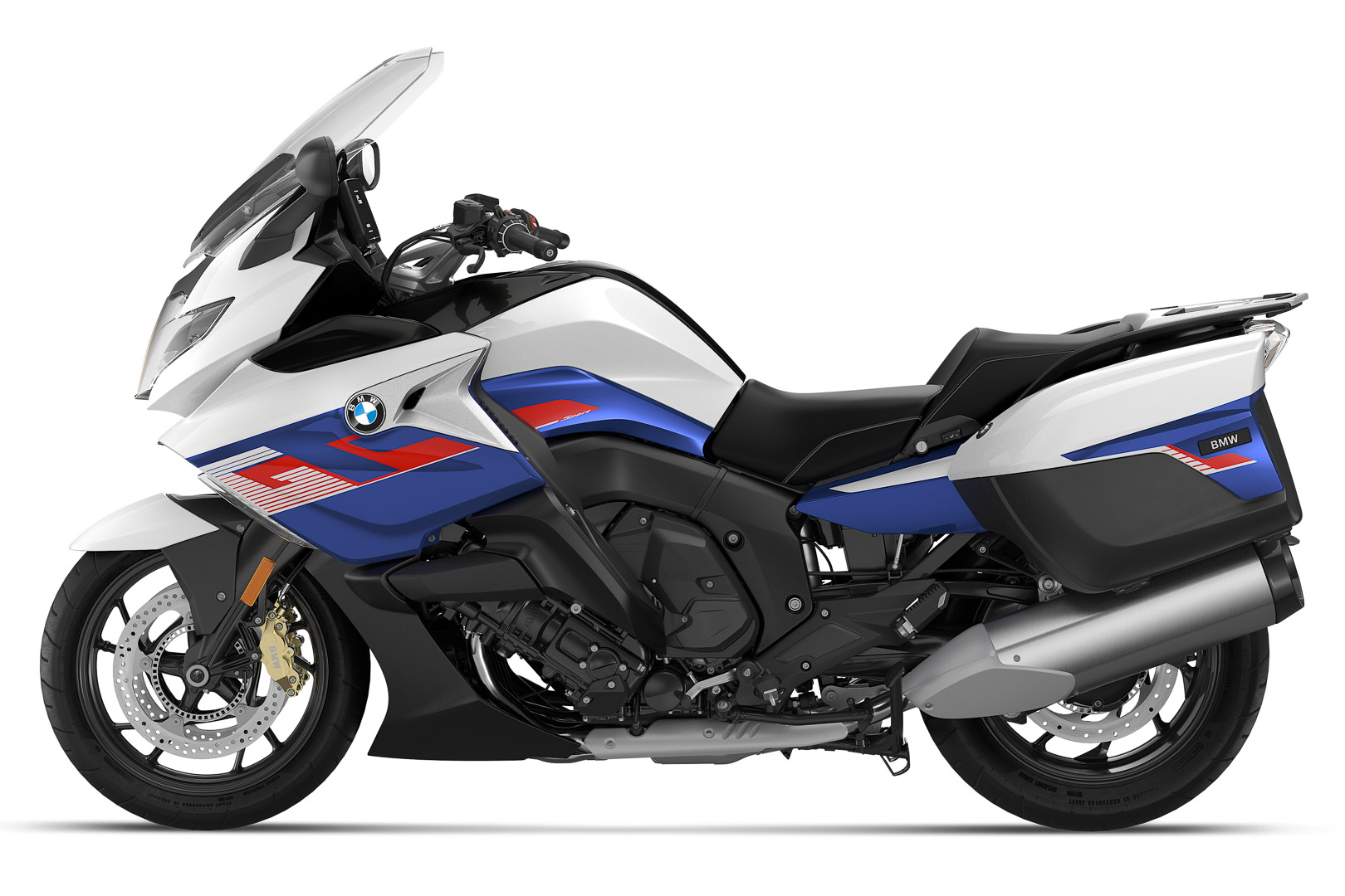

Tell me about it ... yesterday, at 407-ETR, I saw a beautiful blue K 1600 GT rider flying 145 km / h next to my car in t-shirt, shorts and sandals
![[Image: 78a28a7f37bcbc35dfa6b1b5adff2cac.jpg]](https://cb1100forum.net/forum/uploads/imp/202207/78a28a7f37bcbc35dfa6b1b5adff2cac.jpg)
