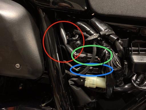

Hi, i can use some technical help on installng the boosterplug I recently received.
On 3rd picture the red circle was pointed out as the AIr Intake sensor by someone from customer service from boosterplug.com. However I only can find a 2 wire connector (blue circle), but the connectors are not compatible with the boosterplug. The response from boosterplug was that Honda never uses or has used the type of connector for the AI sensor and sincce then no more e-mail assistance from them.
So if someone can point to me with a picture the Air Intake sensor on a Z018 onwards Honda CB1100RS or even on an older model, that would be great. The AI sensor is part 31 on the Honda drawing.

Tsmetjen they are pointing at the right place with the red circle and none of the connectors you show on the picture will fit.
The one in your hand looks to be the connector in the blue circle which is the sidestand switch, which is easy
to find once you follow the cable down to where the sidestand switch is mounted.
And the connector in the green circle is the fuel tank connector with three wires.
The intake air temperature sensor is the white ( unplugged ) part with the two mounting screws and is located here;
And when connected up looks like this;
At 20 degrees celsius it has a resistance of 2.2 kilo ohm and when warmed to 28 degrees the resistance decreases to 2 kilo ohm.
The cable for this sensor is quite short and a bit difficult to unplug, the connector needs to be pushed forward, then pressed to lift the clip over the little ramp that holds the connector in place and then pulled back.

(05-10-2020, 03:15 PM)max_imp Wrote: [ -> ]Tsmetjen they are pointing at the right place with the red circle and none of the connectors you show on the picture will fit.
What is the reason you want to install the booster plug?
Thx....i will check it ,
