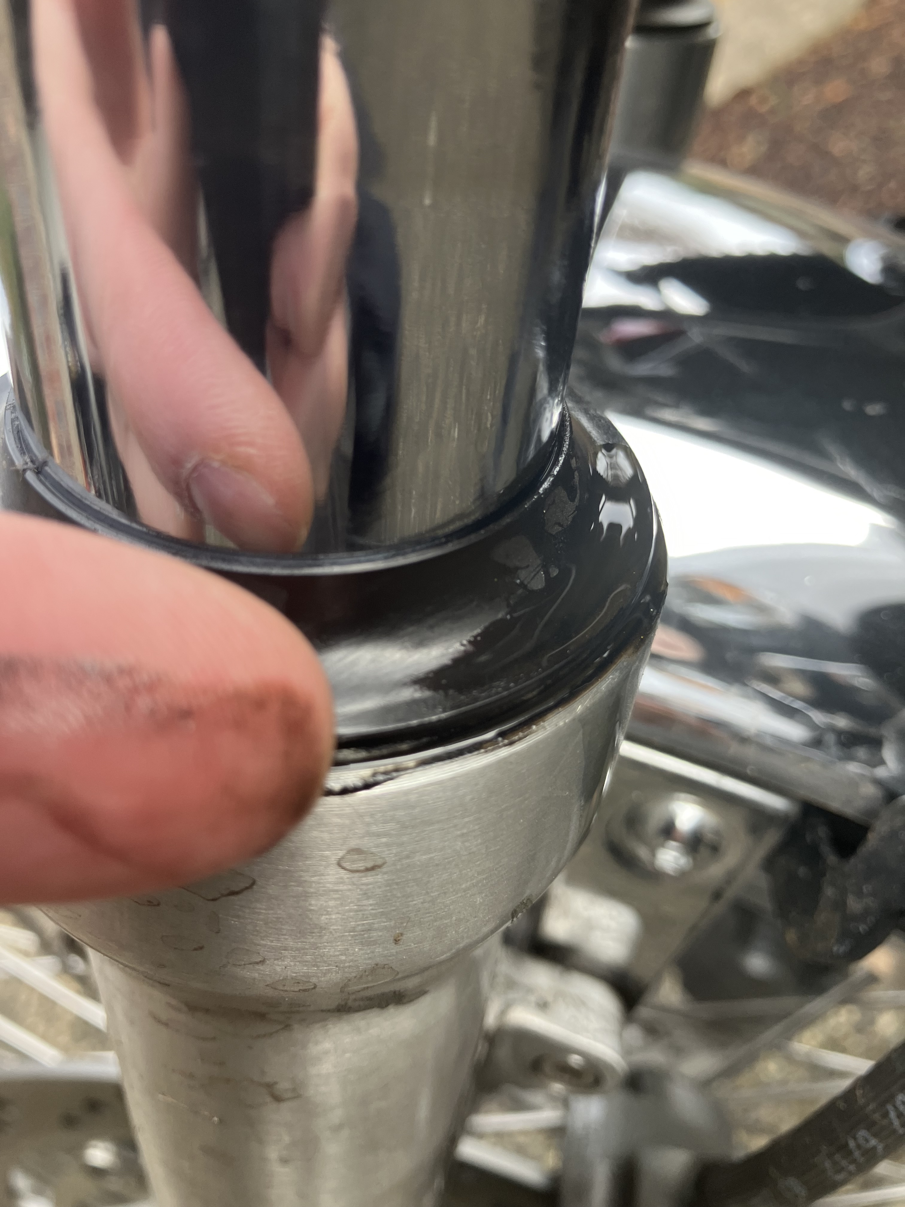

Was ready to head out for Christmas Eve day ride, but noticed a few drops of oil on the floor below the left side fork seal. Ruh-ro.

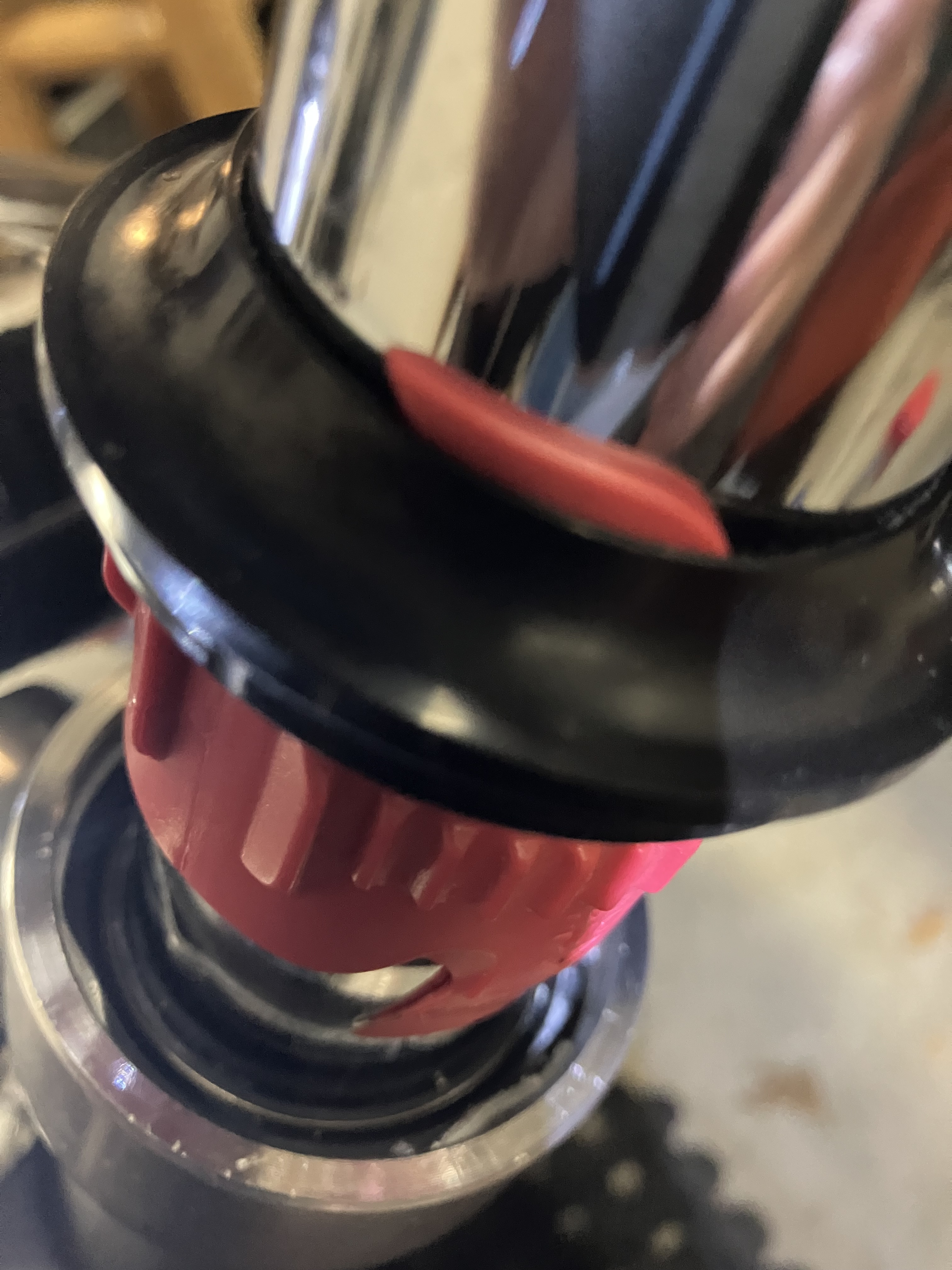

After wiping down the fork and cleaning it, carefully pried up the dust seal

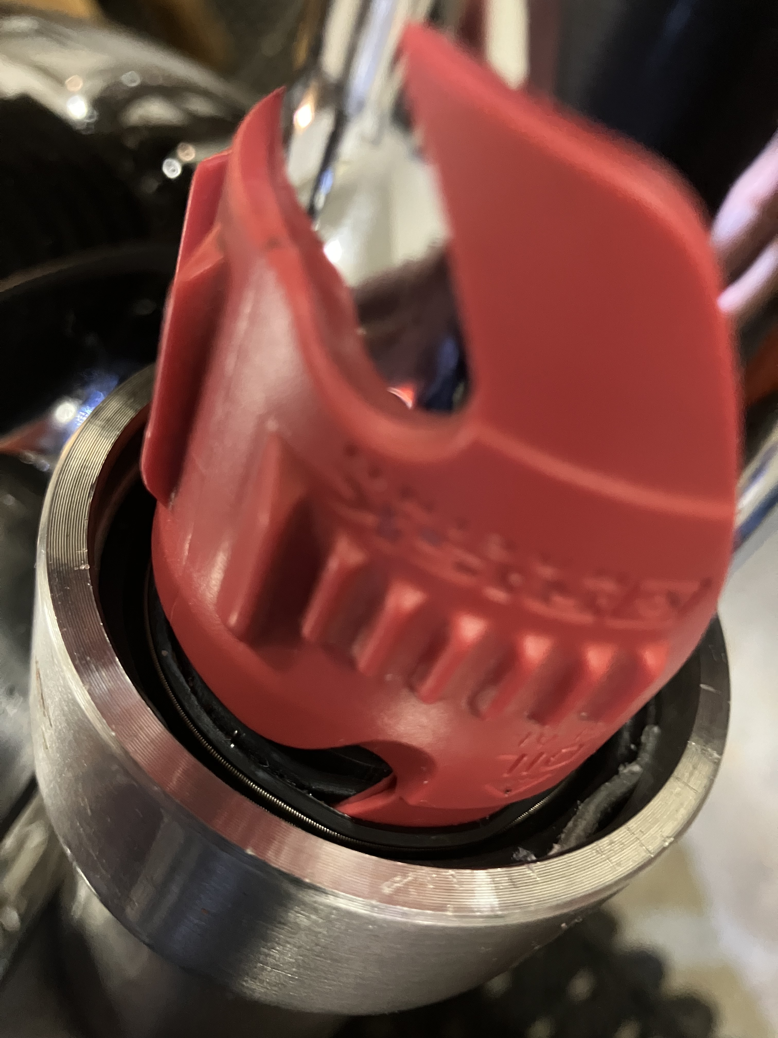

Inserted the hooked end and circled the fork seal 2x

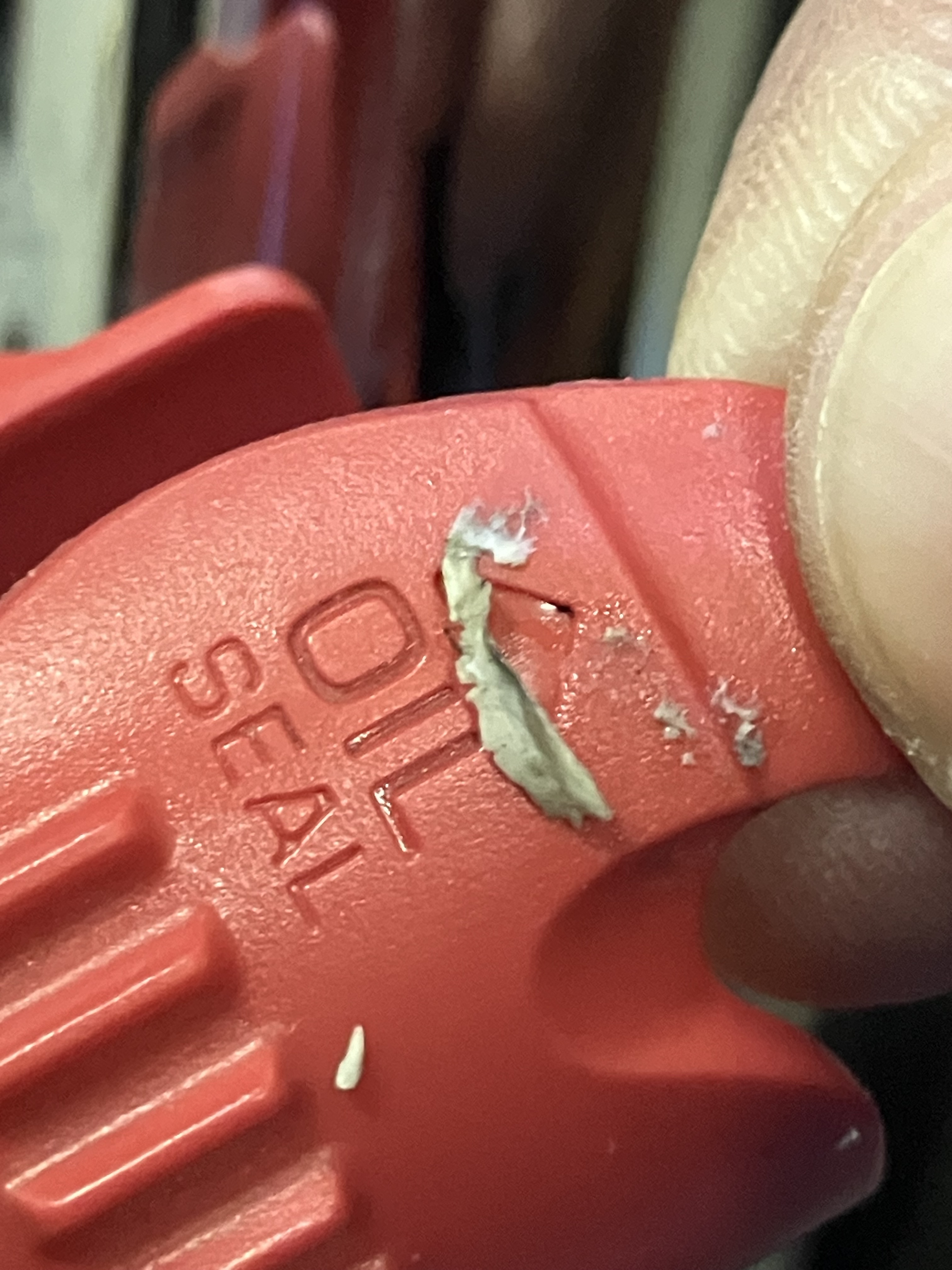

And this is what came out
![[Image: 0e4118ef041b11d16a9538ac44f393bd.jpg]](https://cb1100forum.net/forum/uploads/imp/202312/0e4118ef041b11d16a9538ac44f393bd.jpg)
Yum! Although...does that look like "meant to be there" grease type material to keep the fork oil in?
Or just build-up that was causing the leak?

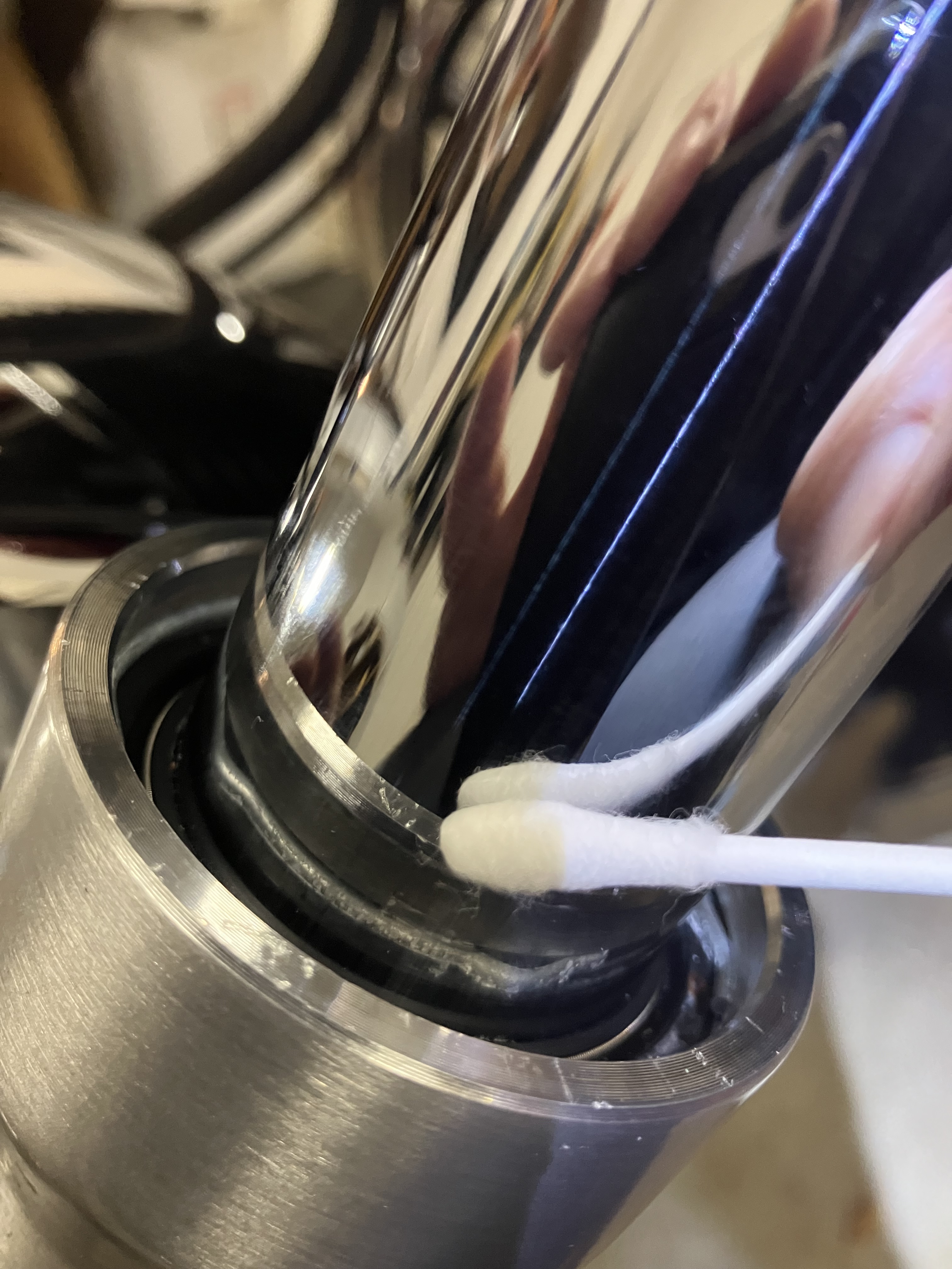

The other end of the tool is for cleaning the inside of the dust cap
![[Image: 1553aa5b677146aafd47e4fbcf97c25a.jpg]](https://cb1100forum.net/forum/uploads/imp/202312/1553aa5b677146aafd47e4fbcf97c25a.jpg)

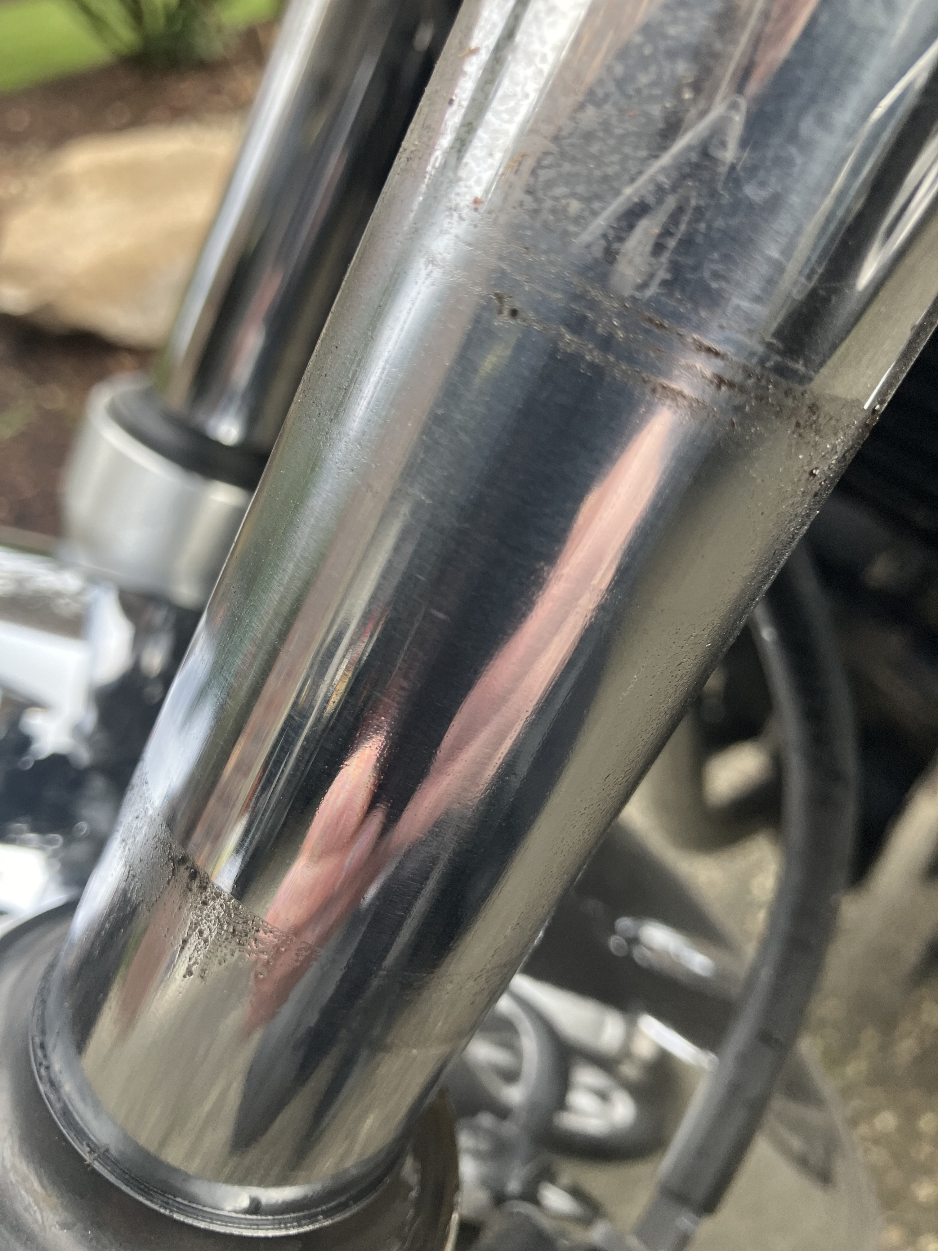

Compressed the forks several times, a bit of residual oil, and did that a few times till all dry
![[Image: 82c918b8645ae87be839c310813e2c3d.jpg]](https://cb1100forum.net/forum/uploads/imp/202312/82c918b8645ae87be839c310813e2c3d.jpg)

Did the same for the other fork and the same built-up pasty material was removed. Forks are bone dry. Now I need to test ride to confirm.
Hi pdedse, the strange "grey matter" you found is simple sludge - not a grease meant to be there. At least color, origin and amount, together mileage and location points this way. Sludge is created by squeezing oil and water through small spaces, over and over and over again. And unfortunately it does neither preserve the desirably properties of either water or oil. Very good that you got it out. It means probably that some water got past the outer seal.
