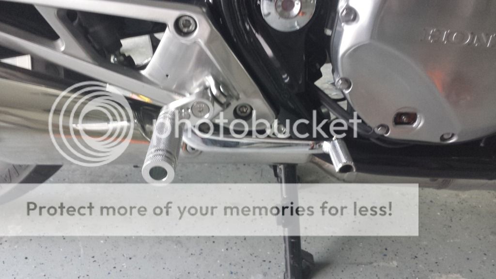

Well, I wish I had better news tonight. My adjustable pegs arrived today, so I spent this evening installing and fiddling with the adjustment. As for the pegs, they are nicely made and sturdy. As for how the fit on the bike, that's a bit of a disappointment. It boils down to how changing the ergonomics makes operating the brake and shifter awkward.
[url=http://s960.photobucket.com/user/Pflugerville_Bike_Guy/media/20150619_200723_zpsmej0jfcu.jpg.html][Image: d10813c5504e3b87039ea36485396e58.jpg]
The brake lever has very little adjustment and needs to be a bit lower. The extra width of the footpeg brackets makes me have to turn my toes inward reach either lever which combined with the extra "step" the brackets create makes it awkward to move my feet around. On the shifter side, moving the pegs down and aft causes the kickstand tab to impede with foot movement while shifting.
These have two positions (half an inch and one inch. When set to the full extension, reach and operation of shifter and brake pedals is awkward. Moving it to the halfway position reduces the awkwardness, but it also does not alleviate my hip soreness. I still need to play around a bit more, but it's not looking promising.

I have been playing with different adjustments on my pegs and thanks to forum member wiredgeorge sending me a message with some helpful advice, I am optimistic about finding some much needed comfort on the bike.
What I perceived to be the biggest issue actually was a simple fix. The side stand tab that was in the way needed to be bent down about an inch. It makes flicking the stand down a little awkward, but nothing I can't live with. That let's me position my shifter and footpeg just right on that side without the side stand tab impeding my boot moving around.

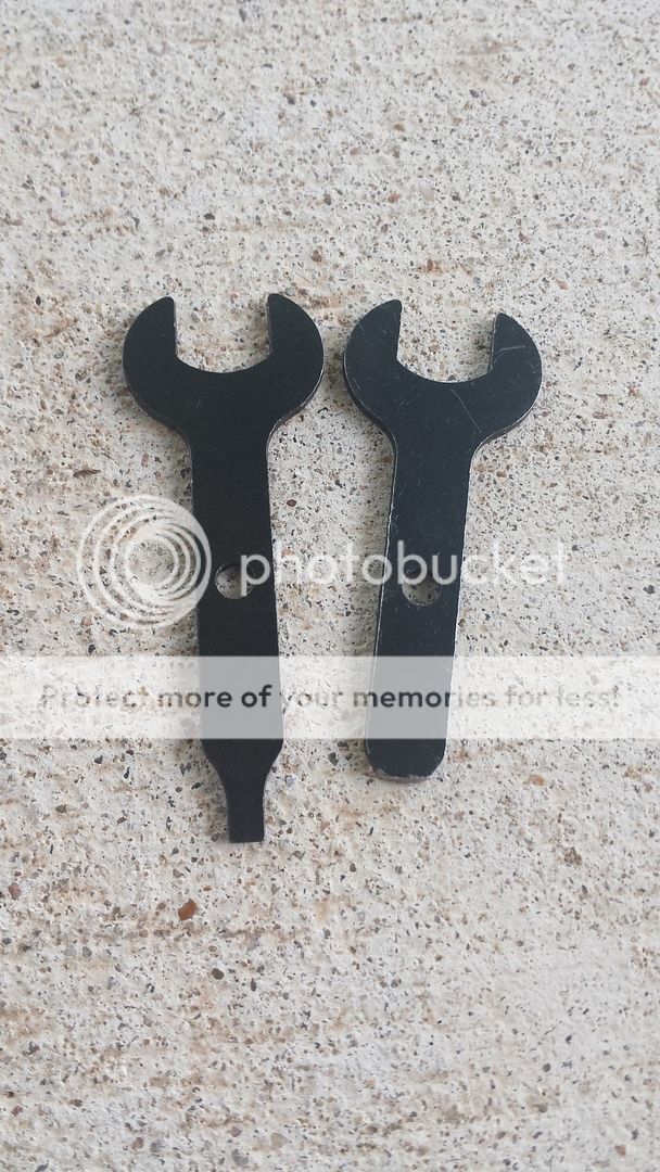

The last challenge came when I needed a very thin wrench to spin the threaded rod the last few turns. As you can see, not much space between the space between the 10 mm nut at the top of the push rod and the 12 mm lock nut is minimal which is due to me trimming that little bit off the bottom:
[url=http://s960.photobucket.com/user/Pflugerville_Bike_Guy/media/20150621_140035_zpsrpnz3mul.jpg.html][Image: 28bb349250201b0c4cec0e579ac6b270.jpg]
I looked around for something I could use. I have a set of really thin wrenches used for adjusting bicycle hubs, but the smallest size I have is 11mm. The head of the wrench is really big, so it probably wouldn't have allowed me any room to swing the wrench. Crud, I'll have to make my own. Grabbed some scrap aluminum and went to work with the dremel tool. Got the basic shape cut out when I went to change bits and grabbed the little wrench used for tightening the collet. Doh! That's a 10mm wrench. I had an extra one from my recently deceased dremel tool, so I cut the little flat blade tip off so it fit in the small space better. Bam!
[url=http://s960.photobucket.com/user/Pflugerville_Bike_Guy/media/1434913782403_zpsmhfnywus.jpg.html][Image: 1fea4aed9c557ff430bef5482df9c63b.jpg]
It's been raining off and on today, but it stopped long enough for the roads to dry and I snuck out for a spin around the block. The peg position is at full extension oriented 45 degrees down and aft. While not roomy to the extent of say my V-strom, it's noticeably better than before. The shifter is adjusted and very comfy to operate. The brake is still a tad high, but not awkward. I just have to lightly lift pressure off the peg and swing my toe over on top of the pedal. I'll stick with that and see how it goes with a proper ride. So far, so good.
Thanks again wiredgeorge!
