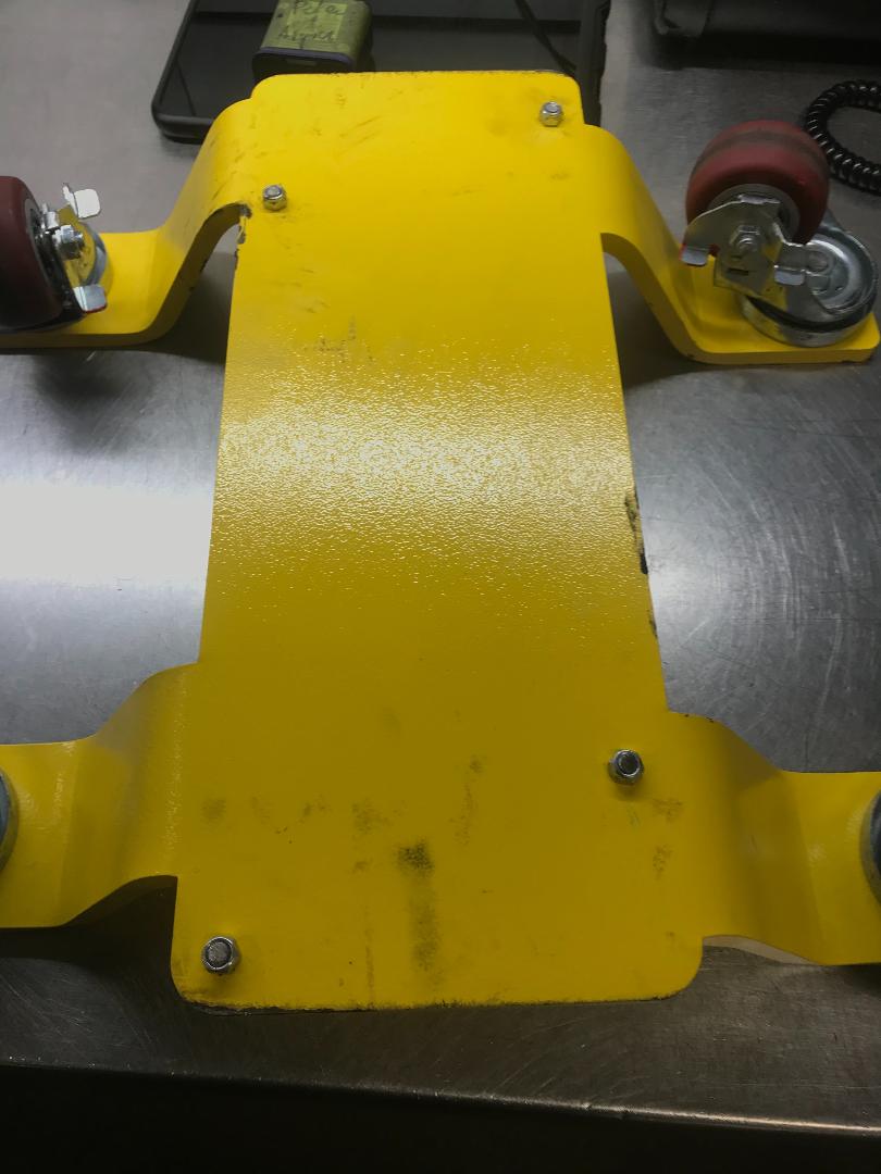

PB, I have one like yours. It came with a piece of non-skid to stick on. Didn’t yours?
If the non-skid wears out I’ll cut a piece of rubber material to put on it.
Think rubber will wear out too quickly...metal or wooden strap across one side will solve the issue
I actually have some solid vinyl flooring material the Navy (and no doubt others) uses and mounts/moves some heavy duty equipment on. I have it in my garage and it will hold up. Or has so far. Does show dents if the bike is on the center stand too long.
BUT, post a pic after your mod. I might want to do it.

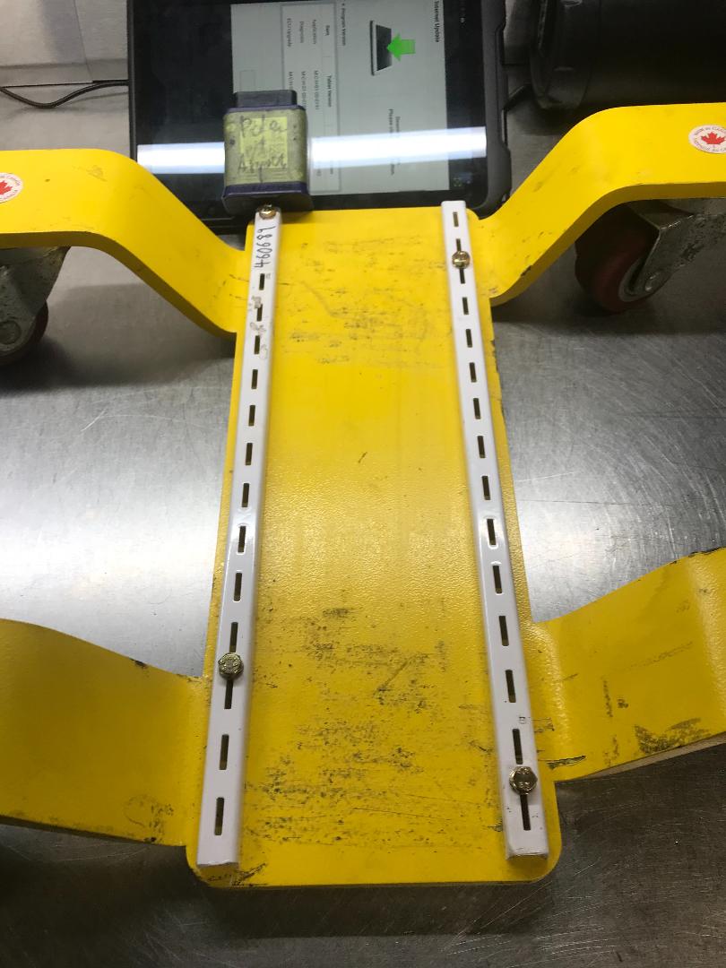

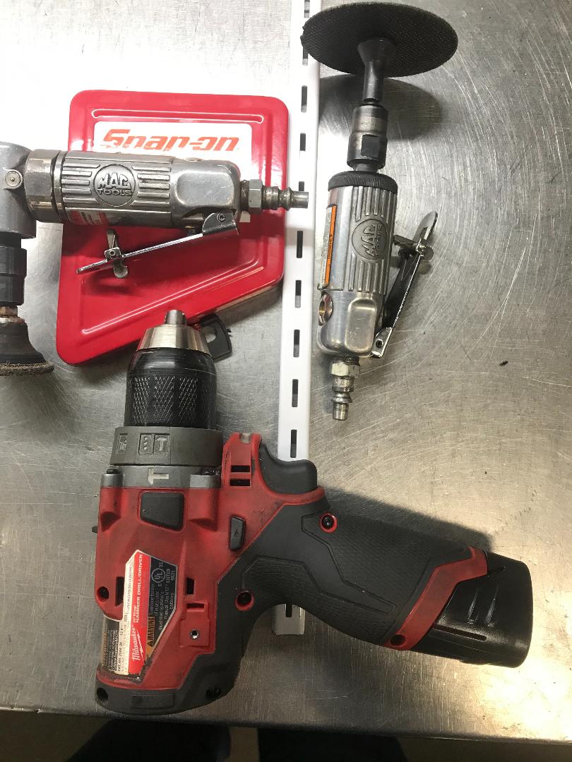

Here is an update.
I used Rubbermaid shelf bracket to modify my dolly, investment, about C$7.00
