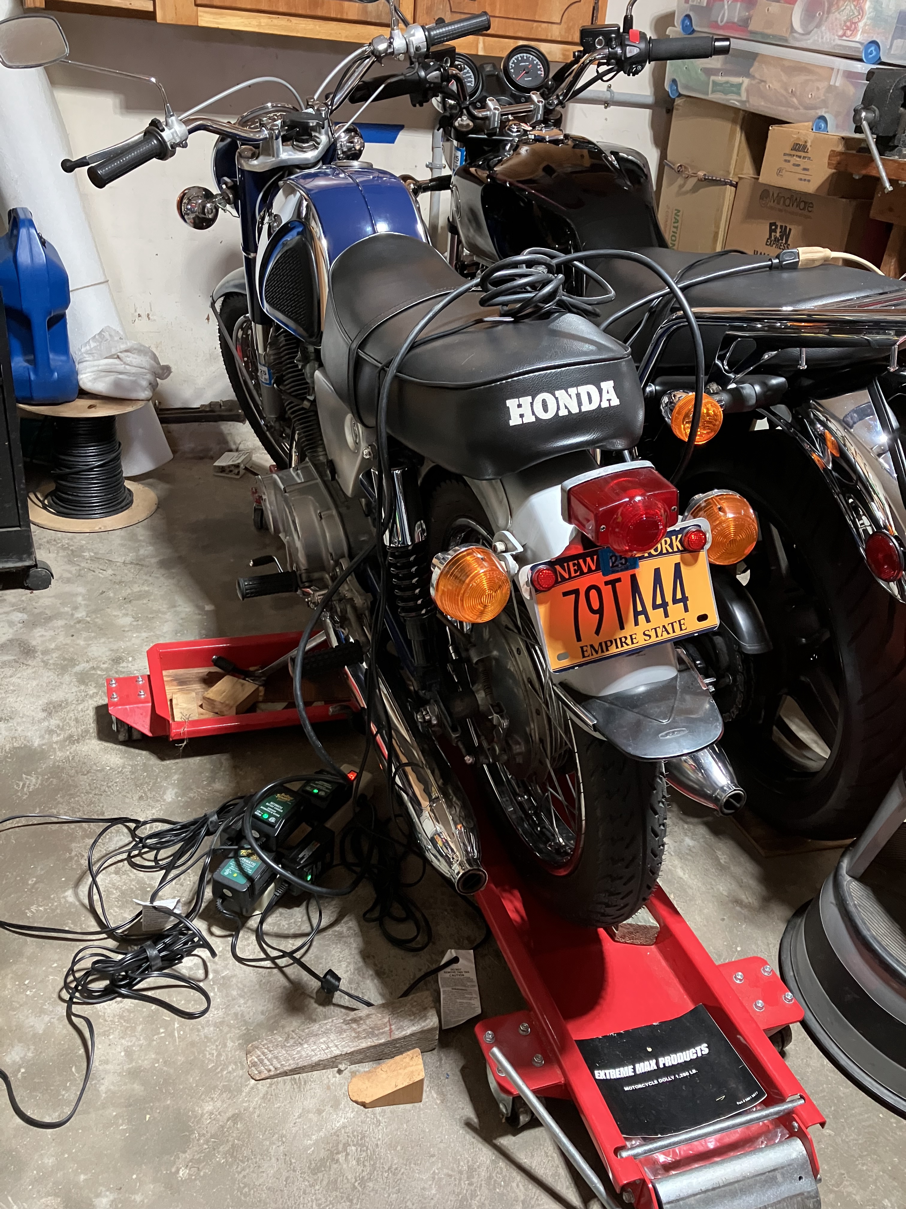

Gone, I have a red dolly that looks exactly like yours. My dolly will also side on my garage concrete floor while loading my bike. I cutted wedges from boards that are placed against the kickstand extension of the dolly, and another wedge against a dolly wheel on the other side.
I use the dolly for moving my 355 lbs CB77, which is a lot easier than rolling my CB1100 up on the dolly. The dolly is a perfect solution for parking both bikes in a tight spot.
