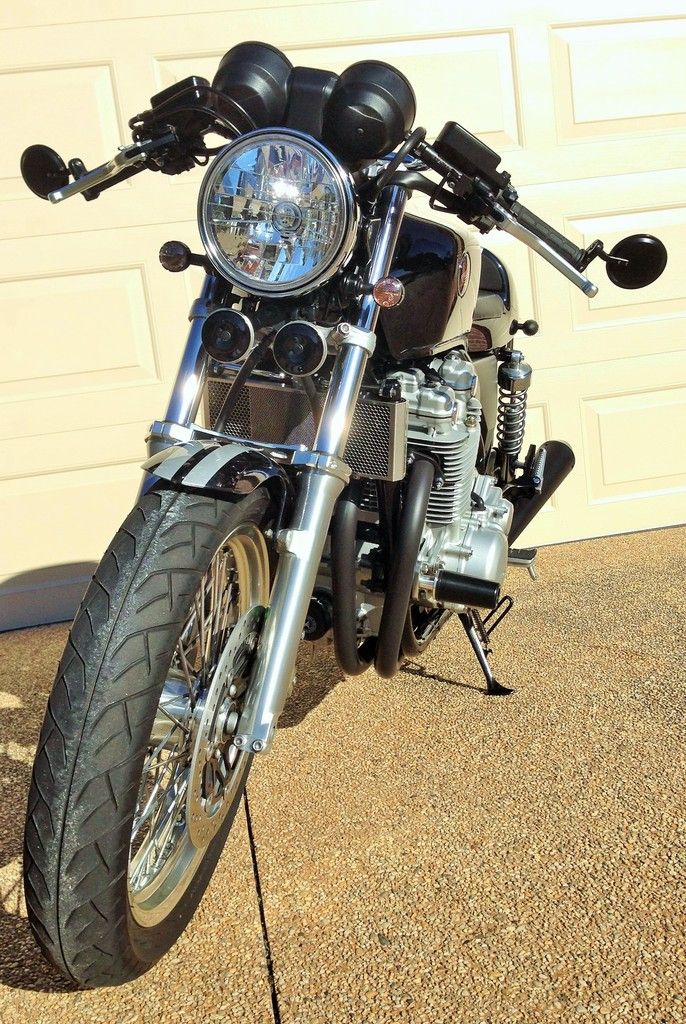

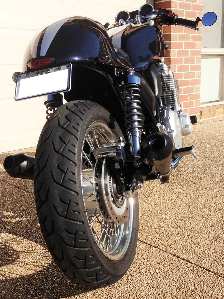

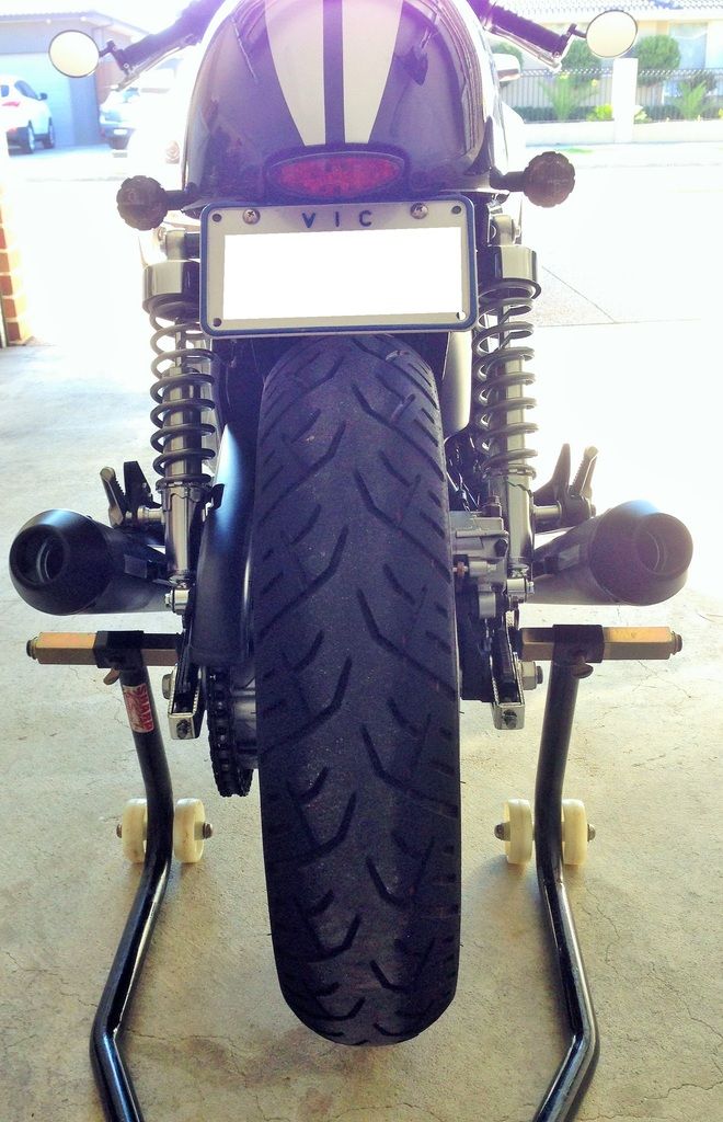

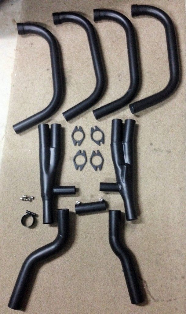

I had to change that troublesome 4 into 1 pipe which hung too low on the right hand side ... so now there is a new 4 into 2 system.
The PipeMasters custom headers run into a set of 2 into 1 collectors that are connected with a balance pipe before feeding a pair of reverse cone megaphone mufflers.
No more scraping on right hand corners and plenty of music from the throttle provides a good dose of that 'new exhaust motivation' to get me out and about on the bike even though the weather is getting bit too cold for a 'fair weather rider' like me.
