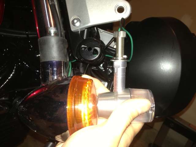

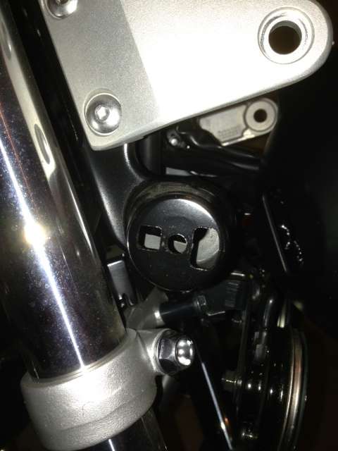

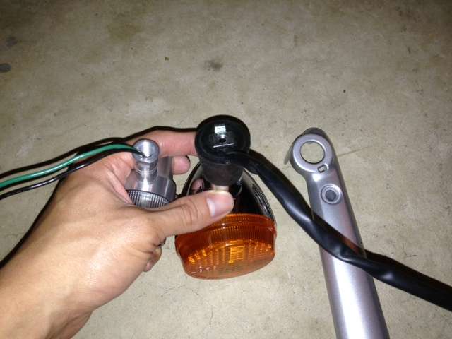

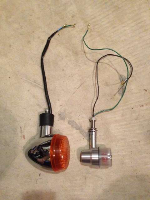

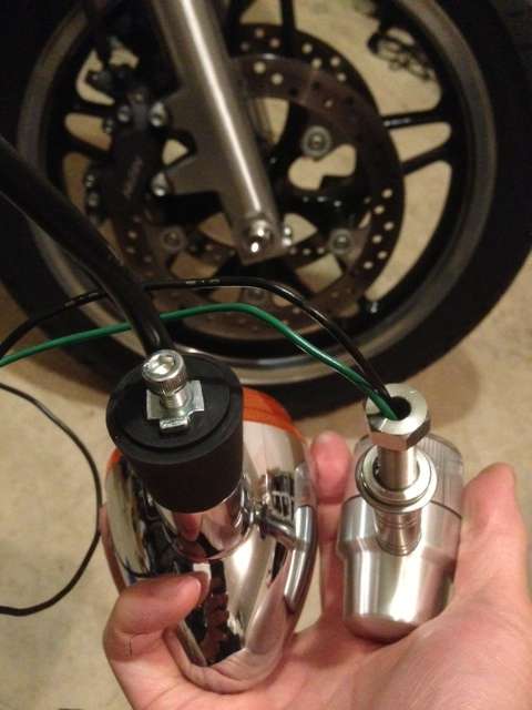

So tonight I was able to take a closer look into the signals and it doesn't look great. The rears could work with an additional large washer, but they won't be mounted with any rubber between the signal and base like the factory. Looking at Japanese model CB1100s, their factory signals definitely had a separate removable rubber base compared to the integrated rubber base on our signals.
The fronts are a whole different challenge unless you plan to make a permanent modification to the stock mount. Even then, the signals won't sit very flush and will actually look out of place. Hopefully someone with more experience or mechanically inclined can chime in. I'd really like to be able to run these new signals.

With the Posh kits, you do not need to rewire anything as they include the factory harness connectors for the rears. The fronts are Male/Female connectors and they plug right up. Unfortunately, the mounting bases are completely different. The fronts can't be drilled out larger as the factory uses a small 6mm bolt and the Posh units use a 10mm bolt. Opening up the hole to accommodate the larger size will tear through the bracket leaving a gaping hole. Leaving an unfinished looking product and probably not that secure either.
Right now I think the only way to get them mounted properly is to make some sort of custom bracket in order to preserve the factory base. Any other ideas or suggestions, please share them!
Hey Mike, not sure how I missed your earlier post entirely. Thanks for providing that information. Looks like we'll have to make custom brackets until someone develops CB1100 specific turn signal adapters.
